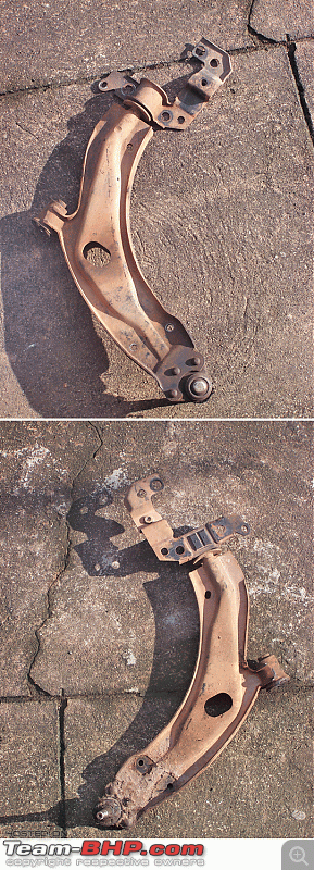

Now on the AC, i believe the "AC filter is not cleaned at all eh! this filter is is somewhere under the dash board and removing it and fitting it back is going to be a long process so i guess its never cleaned?
this way for sure the AC performance will suffer, anyone has any idea on this and does it make sense to get it cleaned? at *** or at local AC mechs?
meanwhile am attaching the pictures of the lower arm and the bill...
