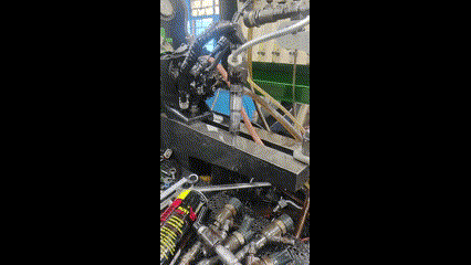

Hello friends.. I'm new to BLR and stay near IIM. My car is a Diesel 1.4 Titanium and c12 yrs old with 230k on odo. A fuss free ownership so far I must say and a great experience with my recent service at JSP Ford Bannerghatta road branch. I'm told that the injectors need replacement as the pressure seems low in 1 or 2 injectors. When asked about servicing options I. Told that Ford does not recommend servicing Gen 1 Figo (they do for the 1.5 tdci). Can someone recommend a good independent Ford expert in Bangalore I can try? I read somewhere in the forum that Hema diesels did a good job of injector servicing but I need a good mechanic to help remove and reassemble. Also is there any recommendations on a good stage 1 or 2 tuners for the Figo? May be it is now time to explore what I couldn't in the earlier years .
An update to my query above - I am glad to inform that my injector issue has been resolved and the servicing was performed at Future Diesel (Bommanahalli) and have been in the industry for many years as I was told. Spoke to Radha Krishnan (the owner) about my issue and he was glad to help ASAP since I had a travel covering 1000+ KMS during the Christmas and New Year holiday period. Do note, I have not dealt with Future Diesel before and I do not know them prior to this issue.
As you all know, I was told by Ford that there are issues with injector 2 and 3 and that it would be better to replace all 4 for consistent performance. The diagnosis matched at Future Diesel too except that they only needed cleaning. Apparently, Ford does not advice servicing the injectors for the 1st Gen Figo however, they recommend cleaning/servicing for the 2nd Gen Figo.
The best part is that the owner was inclined on changing the 2 nozzles since the spray was not as per the mark however, he also said first he will try to clean them manually (not via the UV process). The guy who worked was very meticulous, diligent and patient.
Now to the Cleaning Process (Uploading GIFs where possible to minimize file size)
Reference Readings (this is a pic below)
1. All Injectors are pre-checked prior to cleaning to identify the faulty injector
2. Manual Deep Cleaning including removing the injector sensors, nozzles, o-rings and smooth functioning of the injector parts)
3. Re-assemble and check the spray - Note, the readings across the test tubes you see (injection and return) should be around 750 for injection and around 550 for return.
4. The injector sensor (wire connector - black top) on top of the injector can be adjusted for optimal spray - Note you will see a GIF where there is nothing happening. This was one of the 2 faulty injectors and the only one needing the sensor adjustment.
5. Recheck for spray post adjustment
I have done almost 1500+ kms post the servicing and vehicle runs like a dream - I guess the next step is to get to a Stage 2 remap (hoping the vehicle holds up given the years she has served tremendously well) :
