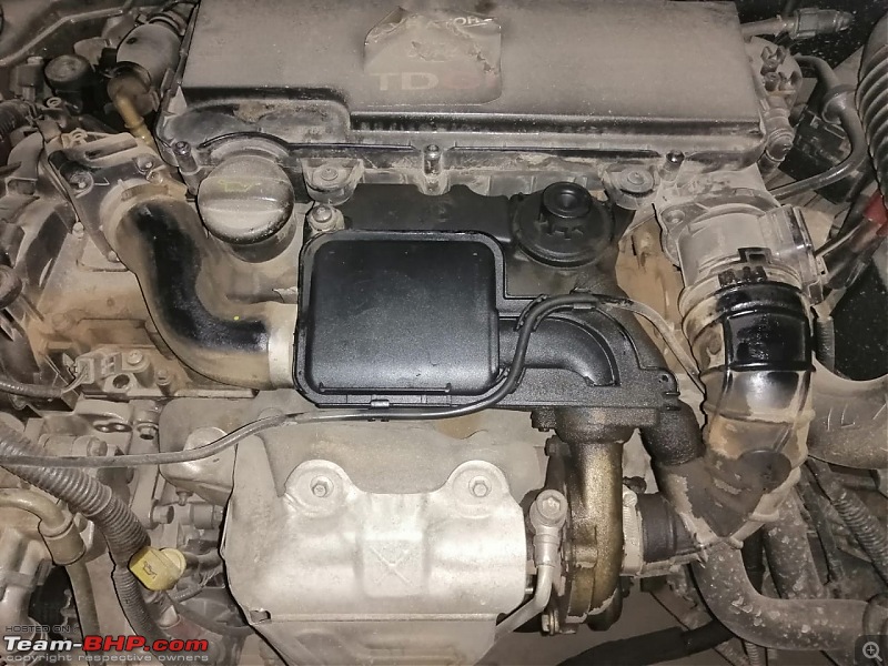

Im seeing this leak in front of engine bay. Can anyone point out what's this? Its been a long time i opened Engine bay and also i ve very low running these days. Noticed this today when i opened up the bonnet.
Review: 1st-gen Ford Figo (2010)-whatsapp-image-20201116-1.33.36-pm.jpeg
Review: 1st-gen Ford Figo (2010)-whatsapp-image-20201116-1.33.35-pm.jpeg
Review: 1st-gen Ford Figo (2010)-whatsapp-image-20201116-1.32.48-pm.jpeg
DRIVE_ADDICT is offline
Old 16th November 2020, 16:51   #10978
Turrrb0's Avatar
Join Date: Jun 2018
Posts: 420
Thanked: 660 Times
Re: Review: 1st-gen Ford Figo (2010)
Seems like the PCV is done for, do get the turbo oil seals also looked into.
