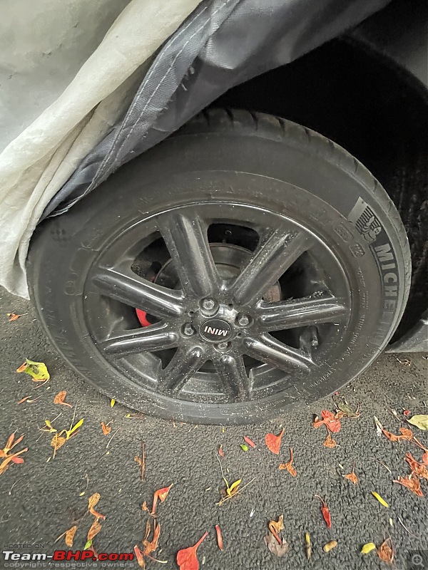

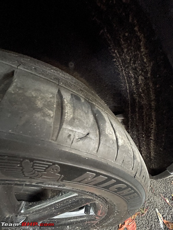

My 4-month old Michelin tyre got this crack | How to claim warranty?
Hi team,
I just observed this crack on my tires recently during washing the car. Tires are still under warranty but dealer is saying that this is cut from small sharp object.
What I feel that cut should be in straight line and not like this. I'm posting this issue here to hear more opinion.
- Is it really a cut and should not be claimed in warranty?
- if it is a cut then, definitely this is manufacturing fault in 4 months old tyres. What is correct way to claim warranty?
Thanks

This doesnt look like a cut as it doesnt have abrasive marks where a sharp object would have pierced. It looks like a crack that has occurred on account of sidewall weakness.
Sidewall cracks can also happen if driven with very low tyre pressure but then it is likely there would have been other marks on the circumference of the tyre.
You need to talk with the Michelin service engineer for your area and not the dealer.
Michelin is usually wary about admitting claims. But then their tyres are good and usually develop faults on account of abuse / improper use.
EV NXT is offline   (1) Thanks
