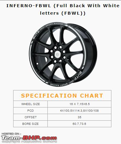

Hi Friends,
I own an 2015 Honda Jazz SV IDTEC Urban Titanium and looking to upgrade from my stock steel rims to alloy wheels. I have decided to buy Neo wheels but couldn't finalise a design yet(owing to multiple options) and hence thought of sharing the ones I liked to know your views.
I am not upgrading my tyres for now and currently on my stock MRF ZVTVs.
Kindly let me know your views by having a look at the pictures of alloy wheel designs posted below.
Personally I liked black alloys and have sorted them(alloys) in the below referred order of preference
1.Athlete
2.Sync
3.Alpha
4.Turbo
5.Inferno
Would like to know your taste/preference here. Also please feel free to suggest any other Brand/Design if you believe that it would suit the 2015 Jazz Urban Titanium.

The inferno looks really nice, with a bit of white lettering, I'd have definitely spent on those set of rims! All the best
