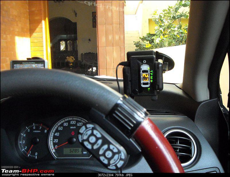

Here is an image of the TPMS view. I have hooked it on to a cell phone holder. You can also paste the same on the dash.Cheers ...
A salesman for LED lights had visited my office & gave me the catalogs of all their products. The TPMS in the catalog looks exactly like the one in your photo!

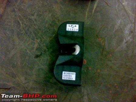

I got the TPMS fitted in my Ikon's tyres on Saturday evening. Here are some pictures:
The sensors fitted to the inside of the rim (right around the valve inlet):
RF-1: sensor #1 for the right-front tyre
RR-2: sensor #2 for the right rear tyre
LF-4: sensor #4 for the left front tyre
Sensors #3 and #4, for the left rear and front tyres:
The special bolts used for fitting the sensors: the bolt is hollowed out from the inside. This bolt fits onto the sensor and goes through the inlet valve. When the tyre is inflated, air travels through the hollowed out centre of the bolt into the tyre. This bolt is special and should be preserved.
Total damage Rs. 6000/-
The display unit is similar to the one shown above, I have yet to find a suitable mounting place for the same.
The display unit also allows you to adjust the following settings:
  1. Minimum pressure of air in each tyre
  2. Maximum pressure of air in each tyre
  3. Minimum temperature of air in each tyre
  4. Maximum temperature of air in each tyre
Upon initialization the unit scans all four sensors one by one and displays the readings from each one in a cyclical fashion. The right front tyre is #1, right rear tyre #2, left rear tyre #3 and left front tyre #4.
The display can be set to either show only the pressure or only the temperature or both pressure and temperature from each tyre.
The system is supposed to sound an alarm if the pressure and/or temperature values vary beyond the set minimum / maximum limits.
I tried the system out on the Igatpuri drive. The tyres had earlier been inflated to 32psi. After the drive when I returned home in the afternoon, the tyres showed pressures of around 35 to 36 psi. So a hard drive and leaving the car out in the sun can increase the pressure by about three to four psi.
