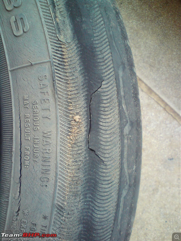

My WagonR automatic purchased in May 2005 has done 40792. On a recent trip to Shivasamudra falls (135km from Bangalore), I had a tire give in a bit. Noticed sidewall damage. Pictures attached. Chintan15 had posted about sidewall damage of Goodyear G3's. I tend to agree with him. Most wear and tear has been these fine crack like lines along the side wall. One of my wheels shows excessive wear on the inner bottom...possibly due to alignment issue or steering side wear and tear or suspension. Alignment I do get done regularly including wheel rotation at every service. Steering seems stable when I drive and even at speeds on 120-140kmph. Suspension these days seems to be an issue recently, with 2 adults and 2 small kids, it seems to hit hard (thunk) even on speed breakers that never used to be a bother.

^^ Thats some major damage.
Get the suspension and alignment checked thoroughly before gettting the new set of tires.

update - I got new tyres from millivision, bangalore (Santosh - good guy to talk to) and got Yokohama A-drive 155/65/R13 for around Rs.2300/- per tyre minus vat. For a set of 5 it came to Rs.13000/- Also got Wonder brand (made in Italy) valves. Rs.100/- each. Was offered china make Rs.50/- as a choice. Fitted the new tyres at Vijay Alignment, who took ages. Vijay's manager/owner Sanjay, got his staff to check my suspension etc during alignment of wheels. The front seemed to have a camber off by -1% while tolerance is -0.3%. He suggested to check for wear after 500km and said they will adjust the coil spring with a welded part or some other adjustment around front suspension to adjust for the tilt. Well, I am not sure here. I will post on this in the appropriate thread.
For now, I got new Yokohama A-drives at 40804km. The ride quality, especially on familiar speed breakers etc. seems to be more cushioned and comfortable. Steering too feels a bit lighter. Sound levels seem same as the earlier Bridgestone G3's.
