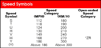

Old 19th October 2008, 13:26   #29
Posts: 3,803
Thanked: 463 Times
Originally Posted by tadukuttan View Post
* Drove to Kerala the next day. Speeds were low, mostly < 140. Did not have any issues, and was pleasantly surprised at the lack of aqua-planing compared to the Michelins I have been using. Heavy rain, and speeds upto 120, the tire was behaving very well. Road noise in the dry was bearable, even on broken surfaces. Grips fine on ghat roads.
* Drive back was much faster, and there started my troubles. Braking performance deteriorates drastically after around 10 minutes of high speed driving. Had a couple of major scares trying to slow down from 180+, reduced speed, and then again I forget all about it, speeds rise only to have the next scare...
I dont understand whats surprising if you are doing 180+ and tyre performance seems to be deteriorating.
You are driving them beyond their certified maximum sustained speed rating.
Source
dadu is offline
Old 19th October 2008, 13:59   #30
Vid6639's Avatar
Posts: 17,709
Thanked: 44,136 Times
Attachment 61521
Source
The tyres are W rated which means they are certified for 270km/hr. How then?
