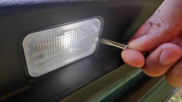

Insert the screwdriver on one edge of the puddle lamp housing and pry open it.

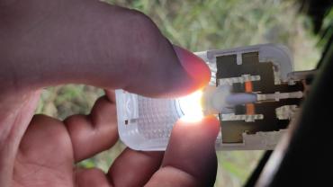

Pull the bulb straight away. (Original puddle lamp bulbs are T10 5 W bulbs which I initially changed to 1 W Osram LED)
Insert new LED bulb. The bulb lit up in both polarities (Can any expert guide me on how that happened?)
Push the cover/assembly back into the slot and you are done.
Enjoy the Light output. I changed only the driver's side LED to show the difference in light.
