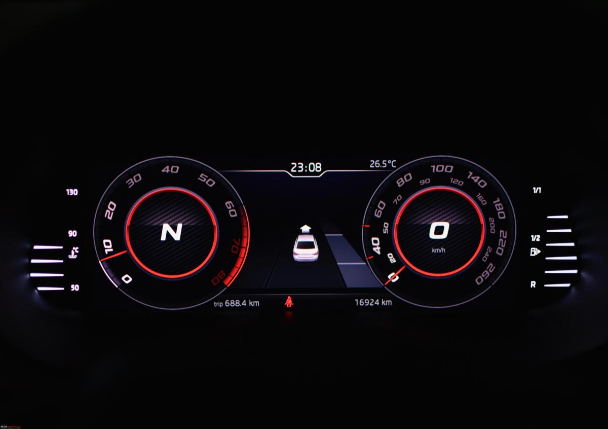

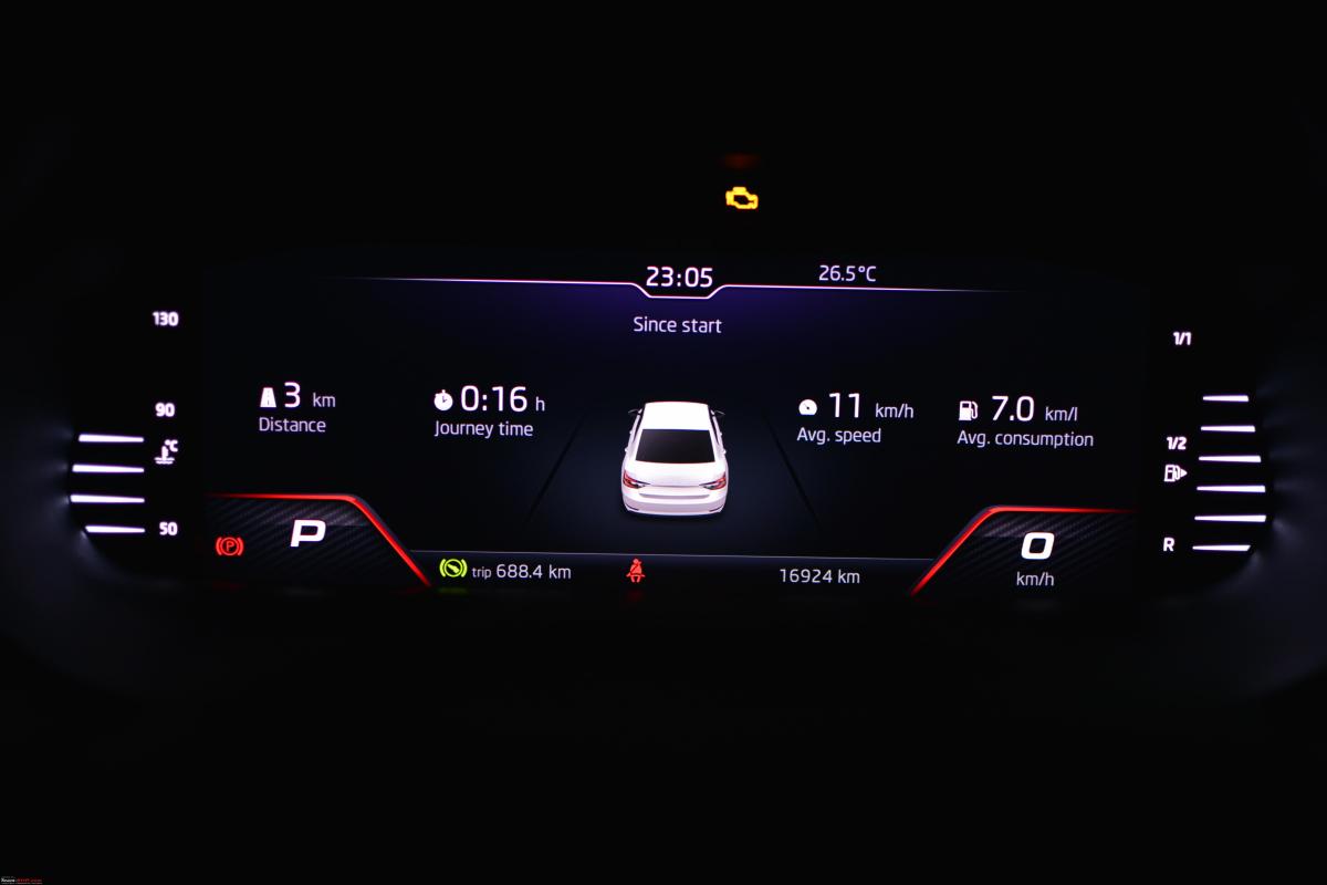

This is another retrofit from the list that was ready before the purchase of the car. My brother and I wanted the Virtual Cockpit more than any other feature or retrofit. However, with the Mk3 Octavia going out of production, the prices for these virtual cockpits skyrocketed all around the globe (Europe, UK, Russia, Czech Republic etc). They were costing 1-1.2 lakh INR plus shipping and customs duty if imported. Just when we were making up our minds to place the order, Nikhil told me that there are Superb clusters which are being used with the Octavia's stock frame which were working out to be cheaper. The catch was that nobody had tried it in India yet at the time, and we do not know about any other caveats that might come with it. Since there was a considerable cost saving, we decided to take the plunge, and deal with any issues when the part arrives. As expected, it came with its own shock. I was initially very disappointed as we weren't aware of the ugly jugaad it came with. It was too late, and the part had already arrived India. If we were to ship it back, it would've costed a considerable amount of money plus the cost of the OEM Octavia cluster. Furthermore, Virtual Cockpit's now cannot be coded to other cars unlike earlier and are locked to the VIN. Nikhil and I discussed a bit on this and decided that if it fits snugly, and if its ugly side is not visible in the cabin, we will proceed with the installation. Unfortunately this is the only way possible for a Virtual Cockpit retrofit on the Mk3 Octavia's unless one is ready to spend exorbitant amounts of money on the part. I'm glad that it sits perfectly and does not have any fitting related issues. The only fly in the ointment is that the image is that of a Superb.
The white bars on the left are for the temperature, there are endless combinations of the information displayed on the screen, some of which will never see the light of the day.
The fuel indicator on the right side (white bars) when in reserve drops to a single bar, and changes the colour to red.

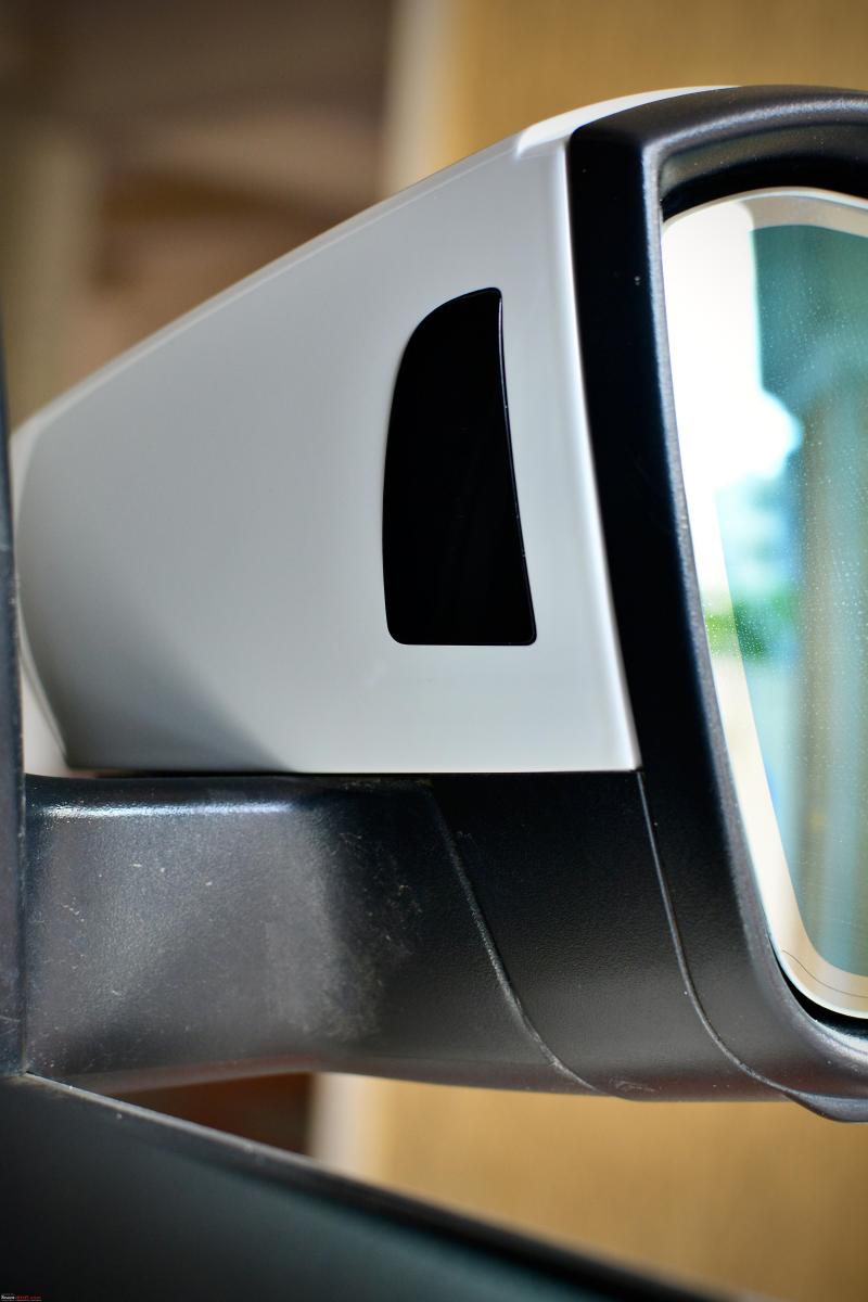

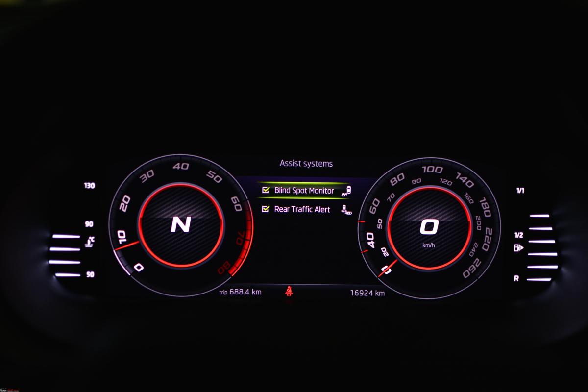

My friend and fellow BHPian Fluidicjoy inspired and helped me a great deal to get the blind spot assist retrofit. This feature is tremendously helpful on the highways, and is very accurate. Unlike the blind spot monitor offered by Japanese and Korean cars, the one on the German cars is far superior. On the Japanese and Korean cars, they have simply placed a camera covering the blind spot, and when the respective indicator is turned on, the camera feed is relayed to the instrument cluster, needing active effort from the driver to focus on the video feed and try to make out any objects or vehicles. However, on the Skoda/VW cars, they worked based off of the radar's placed near the rear crash bar inside the rear bumper. There is one radar on each side, with predefined mounting points. Each of these radars continuously monitor the blind spots in all speeds and give an indication on either the ORVM or a lamp placed on the ORVM cap. This works very accurately, and there is barely any margin for error as the driver only needs to check if the light is lit to identify that there is something in the blind spot.
This was a bonus feature unlocked by the hardware of the Blind Spot Assist retrofit. What this feature does is that it detects traffic and moving objects crossing the car perpendicularly while the car is reversing. It does so with a good margin of distance, thereby warning the driver well before a mishap. Overall, I love how accurate the blind spot monitor and the rear traffic alert features are. They make driving easier, but also spoil us for comfort and luxury. With the direction in which the features on the cars are moving (ADAS, Autonomous driving etc), I wonder if the drivers of the coming generations would know how to drive a car without all of these safety technologies.
The yellow lines are dynamic, according to the steering input, and the two polygons behind the car on the OPS display (left side) are for the rear traffic alert, If an object is detected, the area becomes red with audio warning like the usual sensor sound.

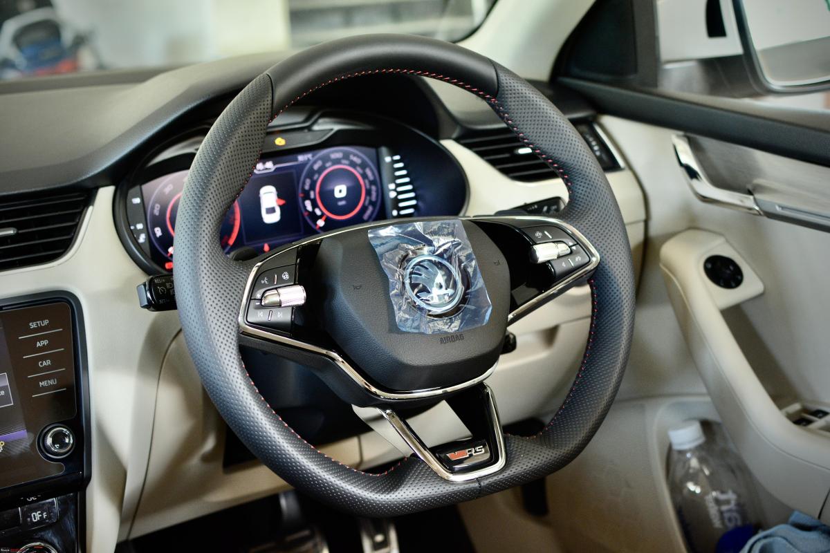

The car's odo now stands at 20k kms. For a car that has been well looked after, and has barely been driven, the cabin and the body felt almost as good as new. However, the only part in the car which reminded of the age was the steering. It wasn't a flat bottom wheel, and the leather had patinated with a gloss black sheen. I did not like this, specially after getting used to the amazing Mk8 steering wheel on my Vento. Furthermore, the scrollers on the Skoda's are prone to breaking, and also do not work properly. This is probably the weakest part on the Skoda's. After installing the Mk4 VRS Steering wheel, the cabin now looks almost brand new and perfect. The perforated leather, red stitching, and the robust scrollers all make it a very good upgrade from the stock steering wheel.
