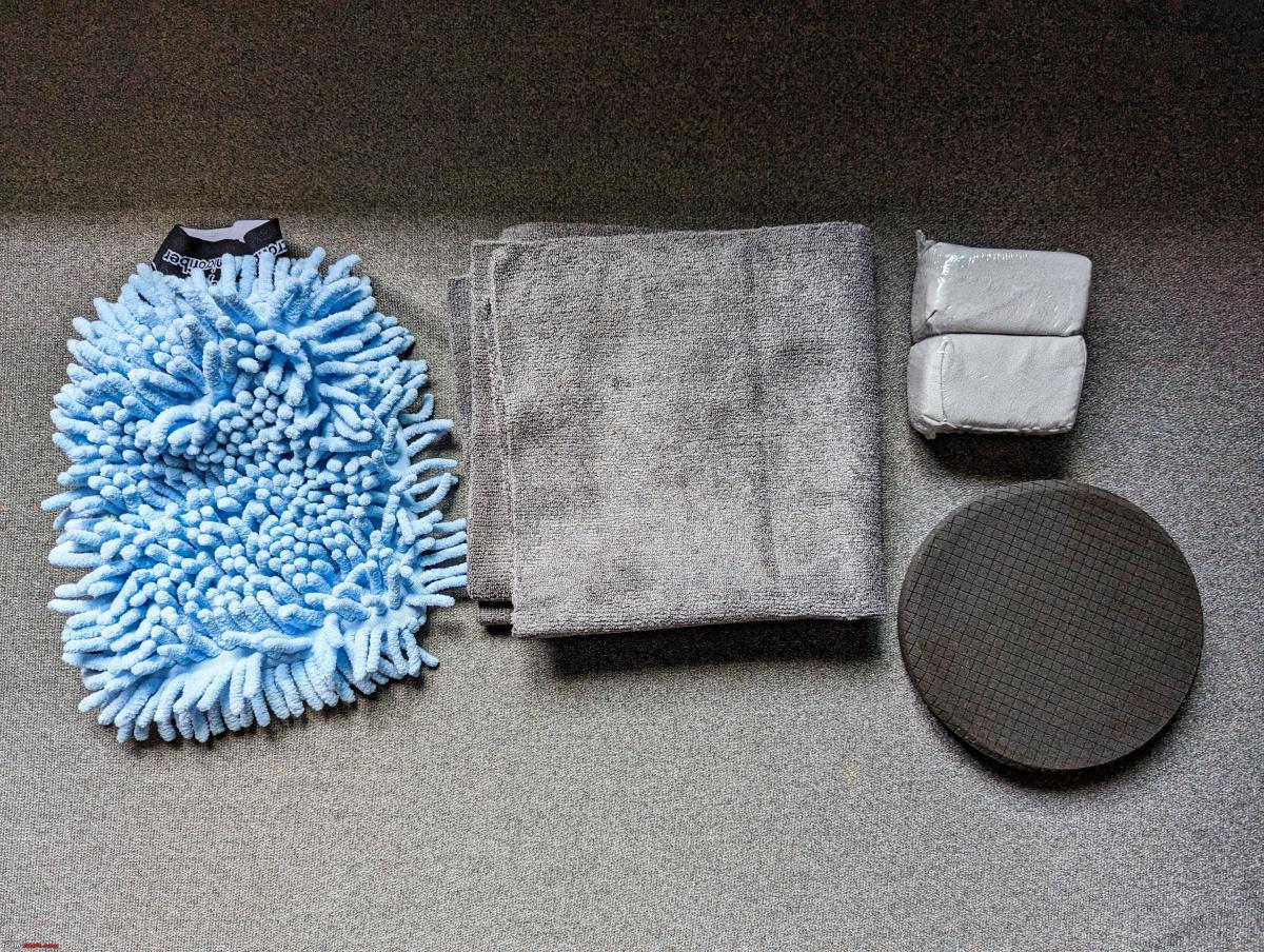

Microfiber Wash Mitt - I prefer a wash mitt over a sponge because it's easier to reach into all nooks and crannies.
Edgeless Microfiber 340GSM - I've been using Softspun's microfiber cloths for several years now. This time, I purchased the edgeless ones specifically for wiping off the coating. Additionally, I have two other 550GSM towels for drying the car.
Wavex Suede Applicators - To prevent the foam from soaking in the product, they include a plastic liner between the foam and suede cloth in their design.
JPT 6 inch Black Pad - Opted for a low-cut pad, assuming that the new paint didn't require heavy correction.

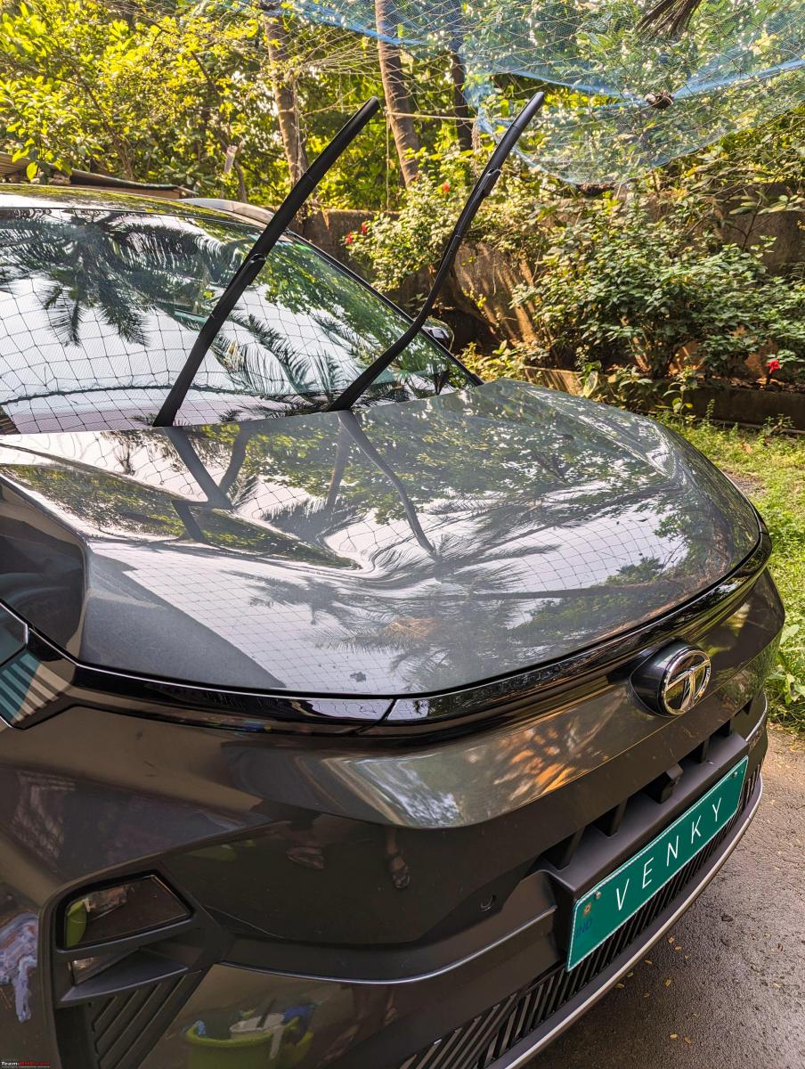

Step 1 : Wash The Car:

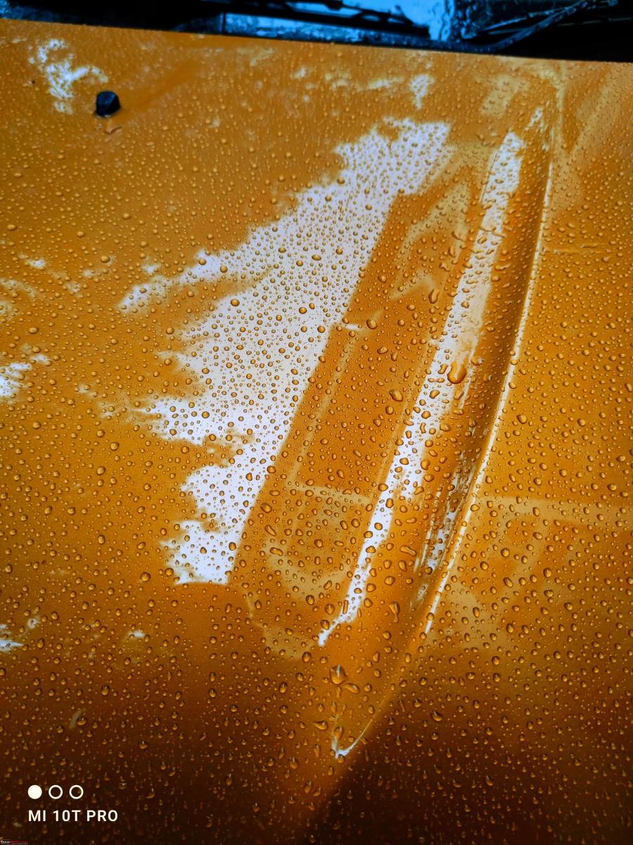

I started by removing all the ribbons and tape, then proceeded to wash with strip shampoo. In the photo, you can clearly see the glaze sprayed on the front grille. Cleaning it thoroughly is crucial to ensure the coating bonds effectively.

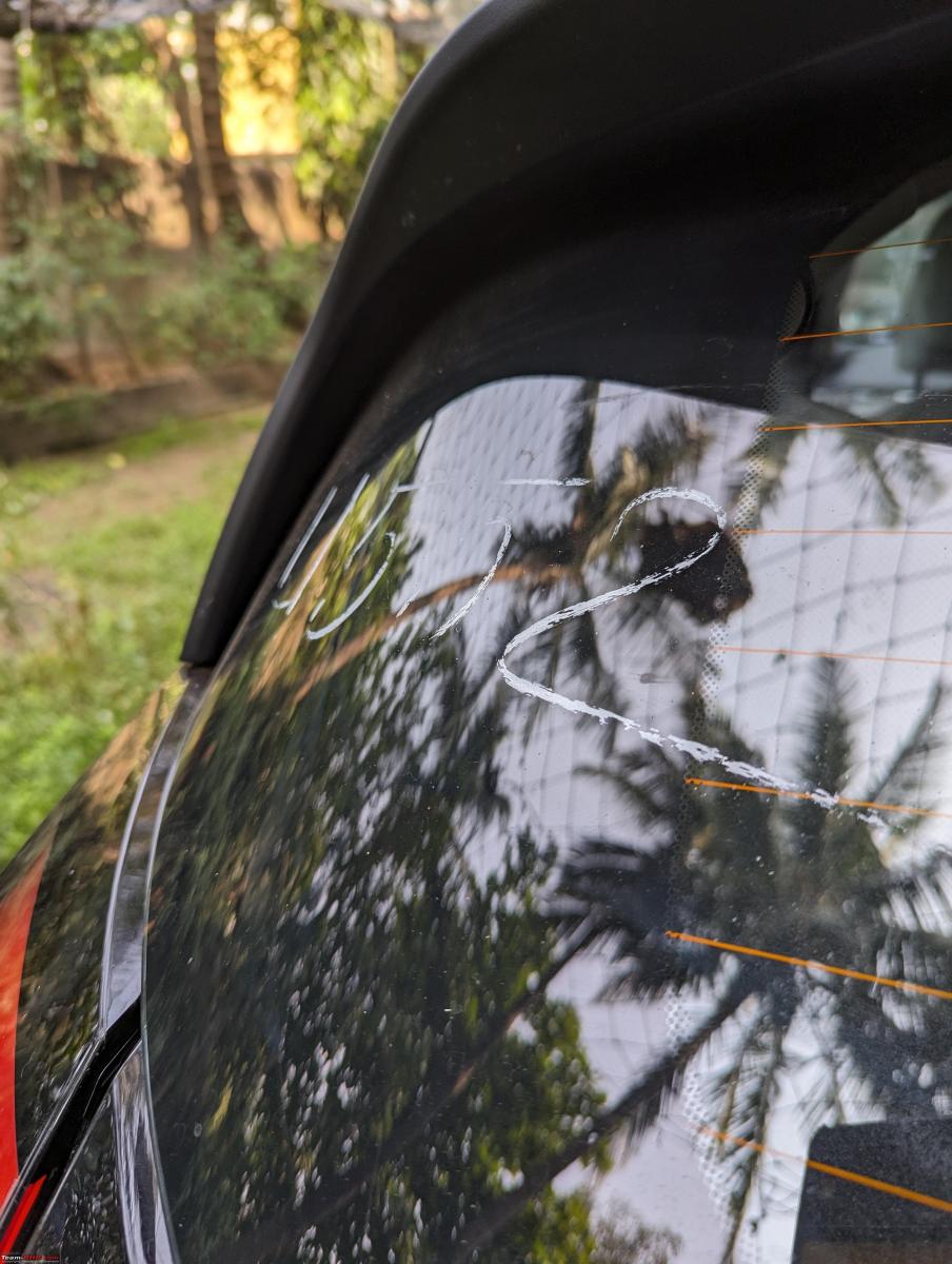

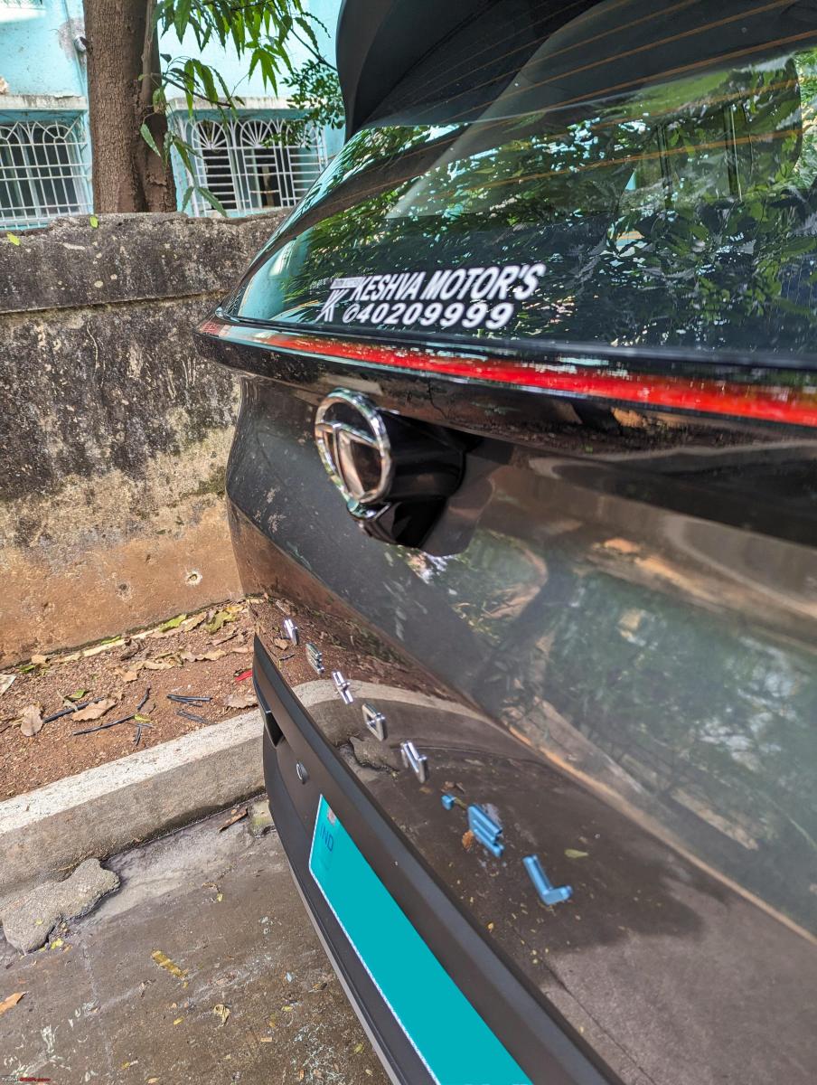

Step 2 : Inspect

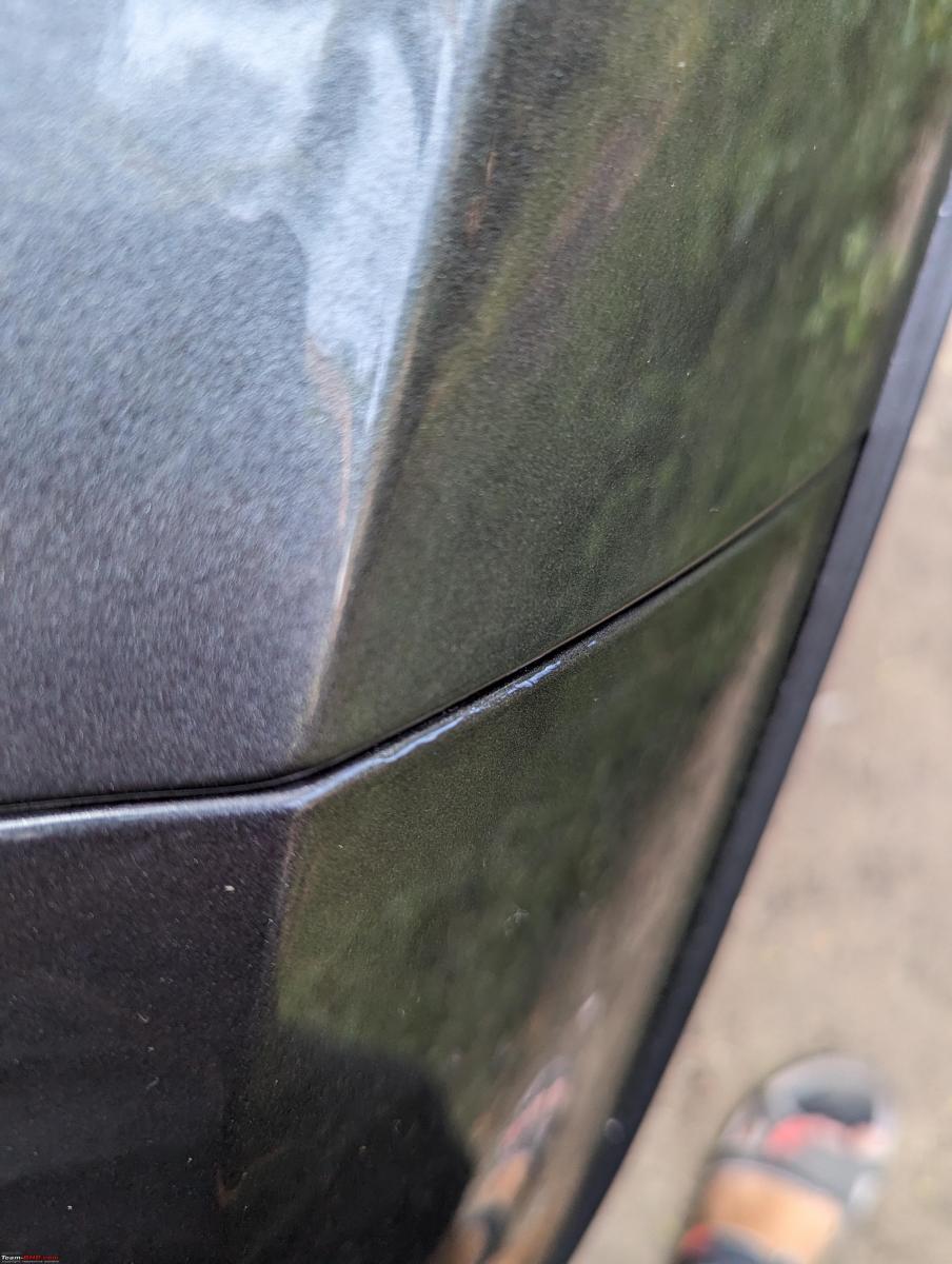

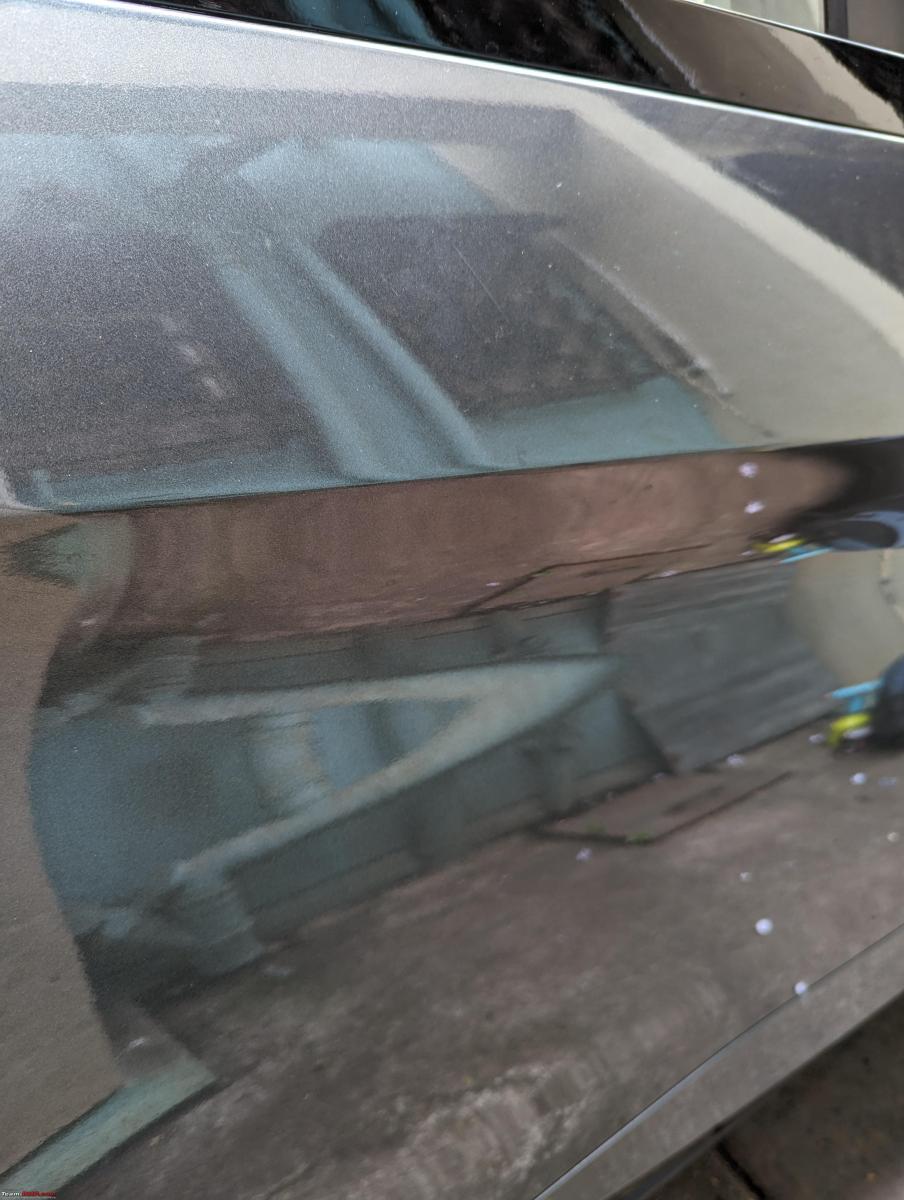

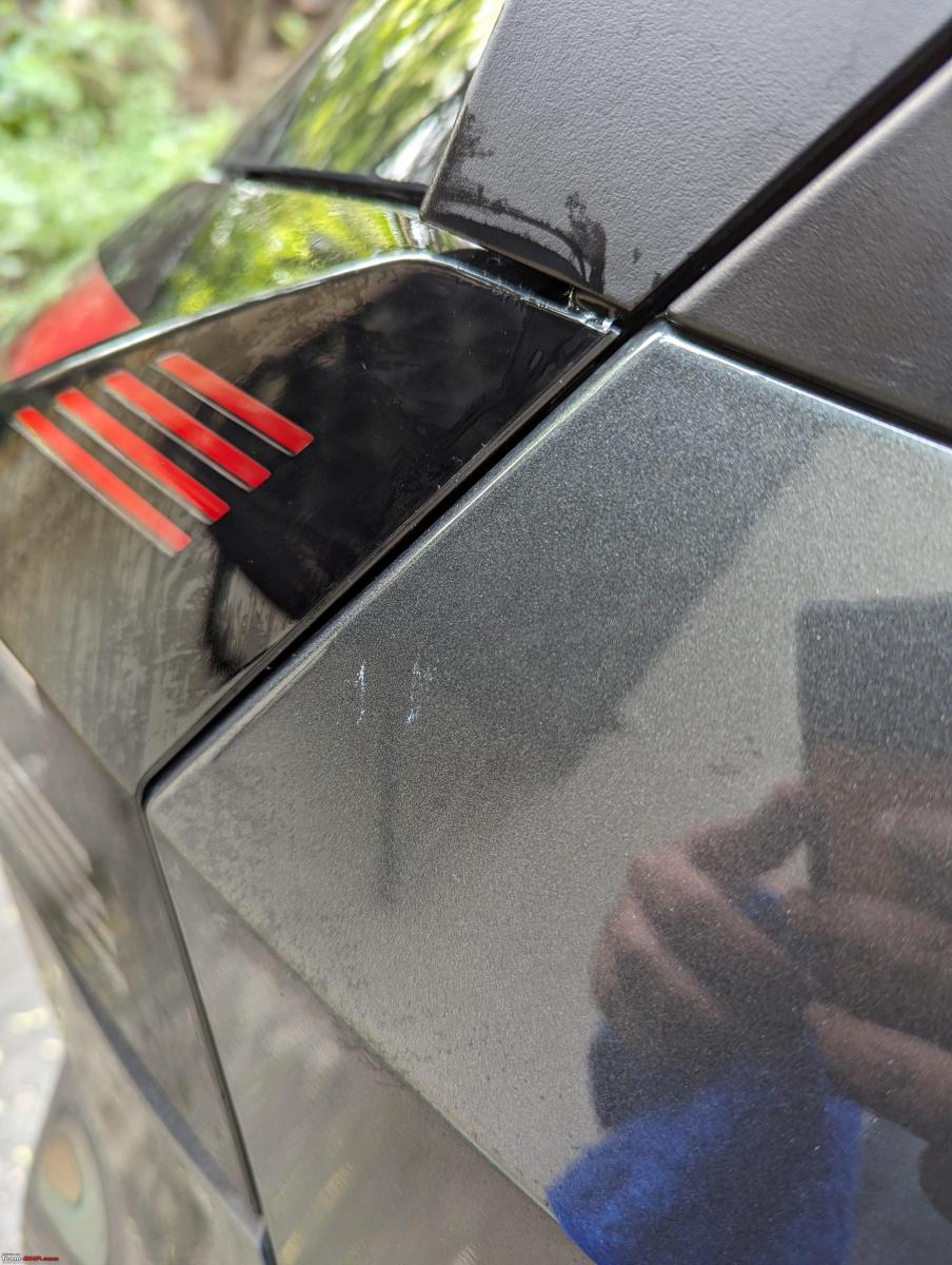

Carefully inspect each panel, one by one, and be on the lookout for any imperfections. In my case, I was addressing relatively minor imperfections, and I've labeled the steps in which these were rectified.
Crayon marking(?)[Claying]
Sticker residue [Claying]
White crusty residue (I'm not sure what it was, but it was also present during the PDI, so I assume it might be factory compound residue.)[Claying]
Light scratch [Polishing]
Sticker residue.

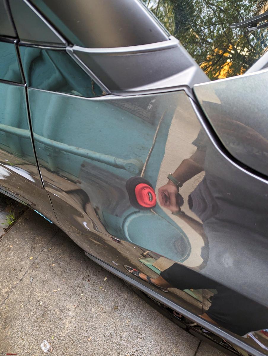

This was the last panel I polished :
