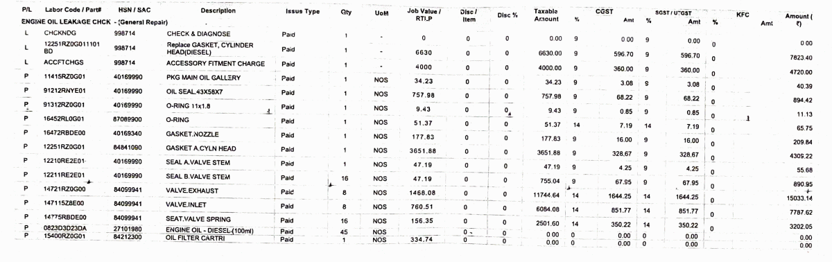

Expecting wrong diagnosis by FNG1, sent to HASS (Honda Authorized Service Centre). HASS confirmed engine damage, but they said damage was in the engine head instead of the engine block. HASS said that the engine gasket and valve seals are cracked/destroyed due to infrequent use and long periods of non operation. According to them the engine should be run for atleast 10 mins every week to maintain the valve seals and gasket health (During the lockdown the car was stationary for months, ran the engine for around 10 mins to charge the battery every month). This seemed like another pathetic excuse my Honda to blame the customer for their poor quality product. Repair estimated at Rs 45,000. They charged Rs. 700 for inspection and estimate.

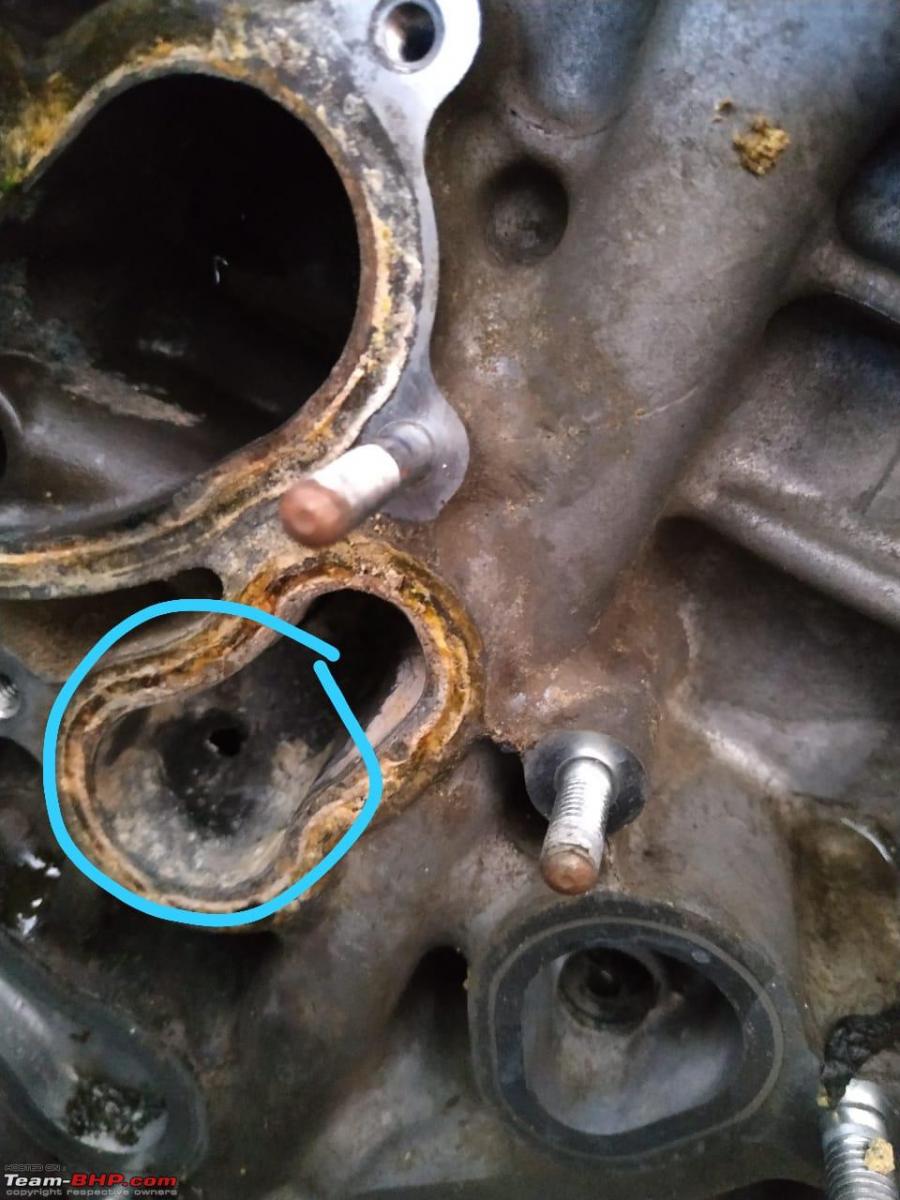

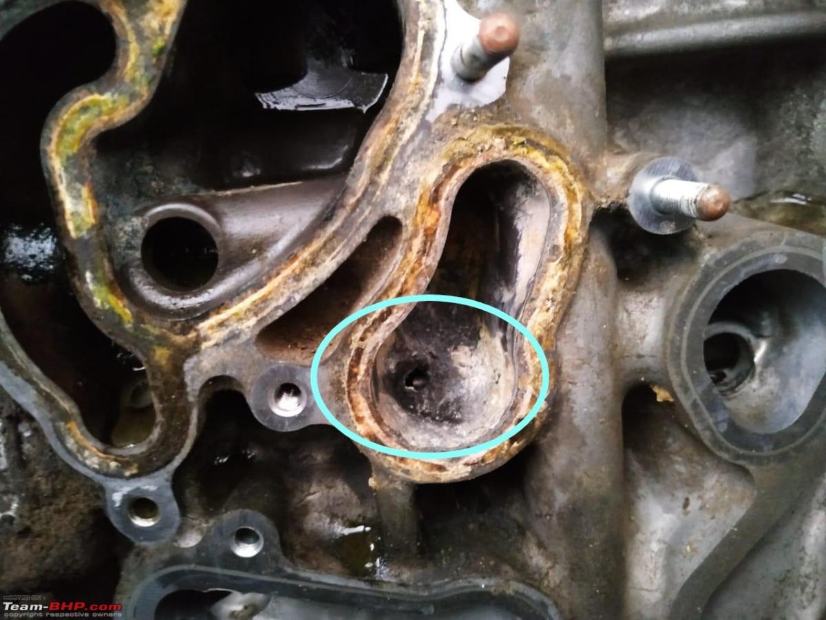

FNG3 found a hole in the engine block, confirming their prediction of damaged engine block.

Having received a negative response from HASS and having experienced their general incompetence over the years, decided to save on towing charges and time, got the hole fixed by FNG3 to stop the engine oil loss.
