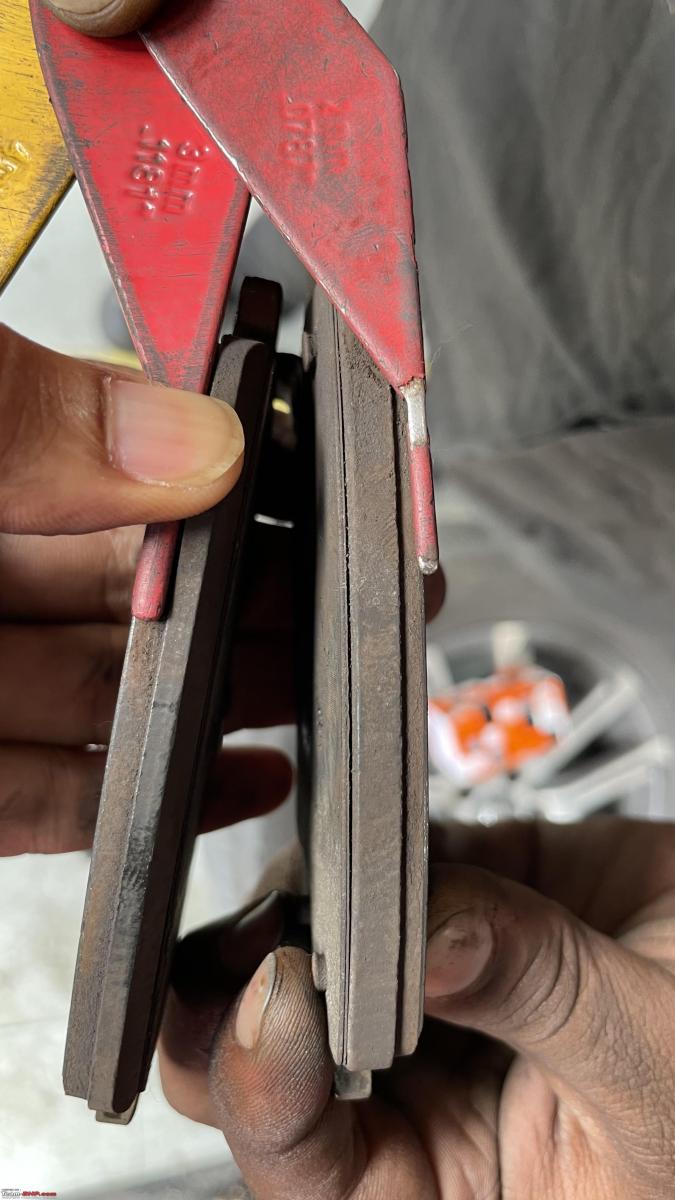

The brake pads actually lasted longer than the earlier set. I used them to the max extent until almost the sensors went off. See the pictures for yourself:

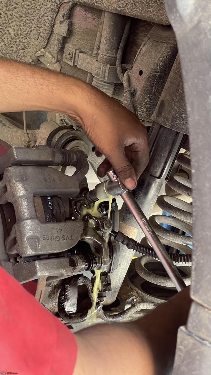

The ASC generally shows you how much life is left in pads or how long it can last. They use these simple thickness measurement tools to illustrate. The thing to do after the pads change is also to top-up brake fluid/ or completely drain and fill. Needs bleeding to be done thereafter.
