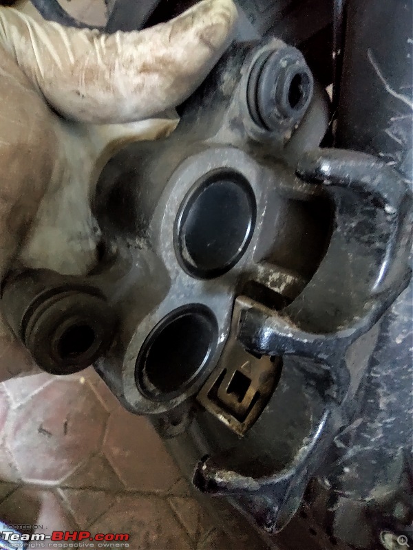

Brake pads: The previous set had lasted 9k Kms for me. So, I had a check at ~17,600 Kms, it looked to last another 1k Kms. I checked for caliper grease at nearby Aru Traders, but they didn't stock it. BHPian Surjaonwheelz came to the rescue and gave me multiple sachets of Magsol via an RE parts outlet.
Worn out pads
Pushed back pistons
Caliper pin cleaned
The caliper pin was greased, couldn't apply it that evenly with surgical gloves
Pushing back the brake assembly took a couple of tries and I noticed that aligning the bottom bolt first was easier than the top bolt.

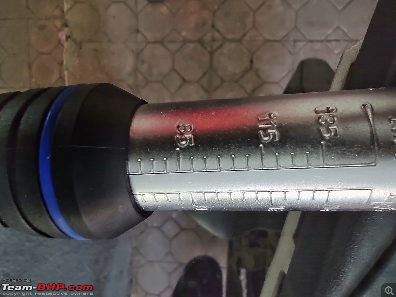

The torque wrench is set to 26Nm for tightening brake bolts

The torque wrench set to 65Nm for tightening the Rear axle bolt
