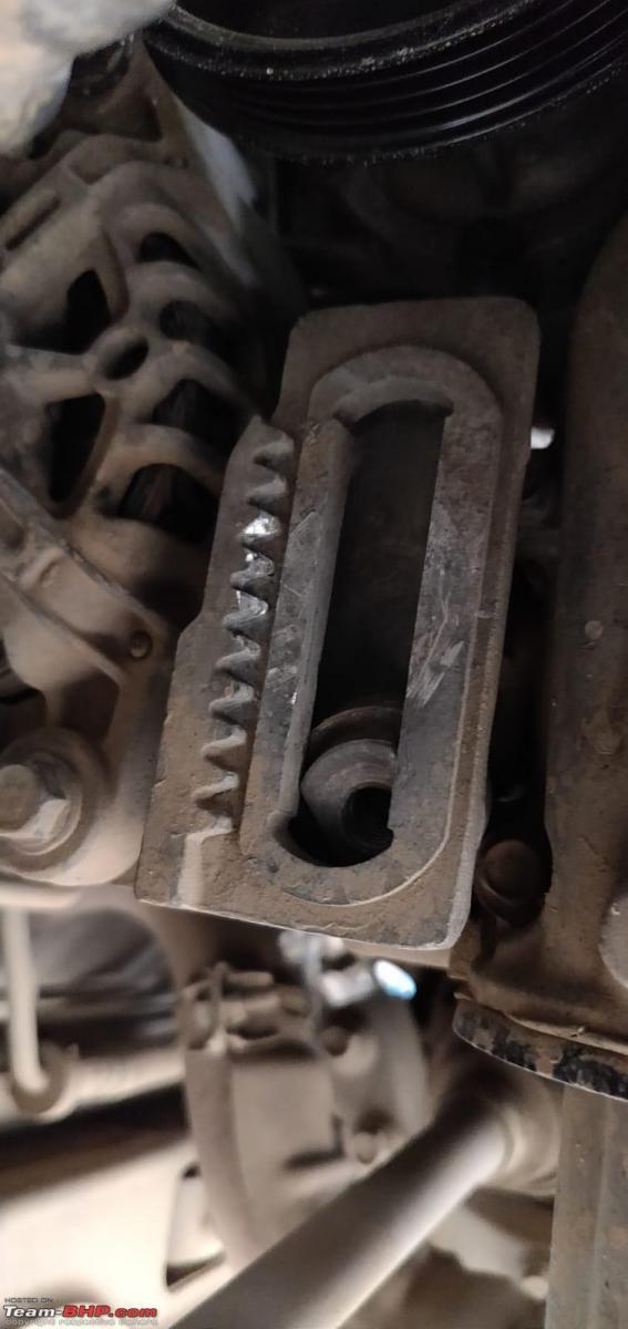

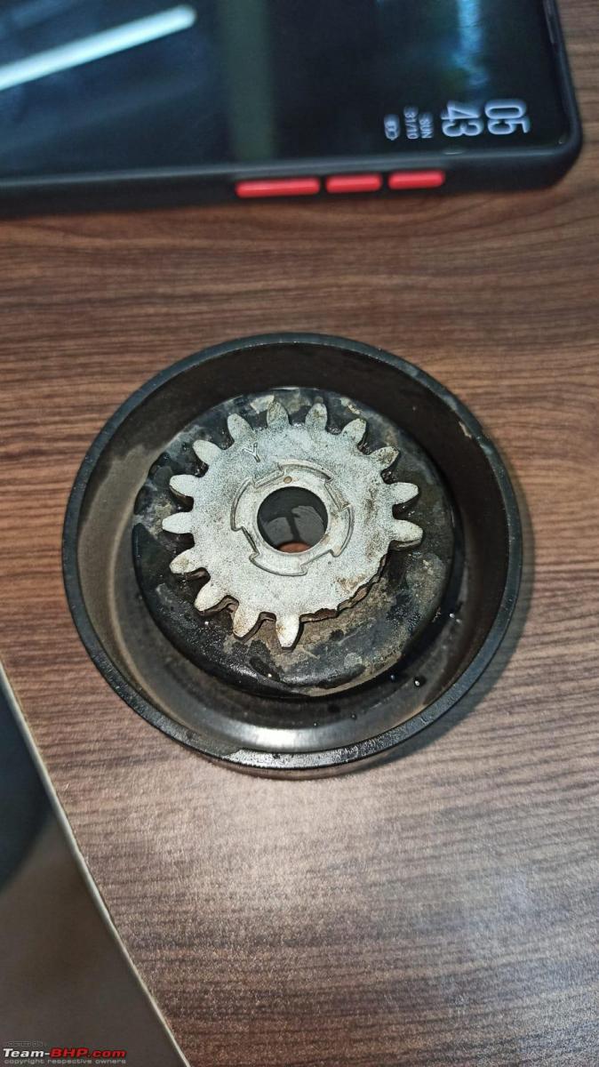

Tensioner Pulley
In a recent servicing, I got to know that the tensioner of the car needs to be changed, I got that order through Trident Chevrolet in Bangalore but when the car got opened for replacing the tensioner pulley it was found that the bracket also needs a replacement.
Broken Bracket
Now finding the bracket has become a 'finding fanny' kind of adventure: surface
The GM doesn't have it in stock, Boodmo has been sitting on the order for 15 days and says they are trying to source it.
Desperate me did some research (visual) and believe the tensioner bracket of Beat Petrol and Sail UVA petrol looks to be very same and might solve my problem because that bracket is available with GM and Boodmo.
  1. Listed for SAIL UVA
  2. Listed for Beat Petrol - 1
  3. Listed for Beat Petrol - 2
I tried confirming it with the mechanics but they aren't very sure of it, is there someone here who faced a similar problem and if you could pls suggest a way forward from here, please.
Update: Beat Tensioner bracket fits well with the Sail UVA, I have got the bracket and tensioner replaced at Trident Chevrolet Bangalore.
