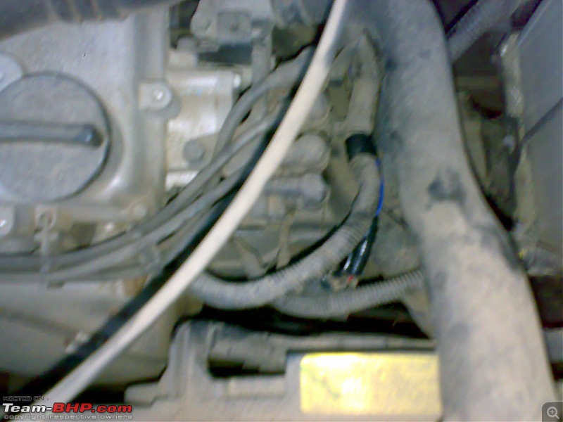

I finallt managed to get the tacho, that i have been hunting for over a yr.
its working perfectly.
ideling at 800-900 and with as at 1000rpm. goes upto 6500 rpm
iam attaching the pic of the main tach signal cable connection, blue wire on the ignition coil. the blue cable is a extension of the green calbe from the tach and is connected to a black cable in the coil wiring.
there are 3 wire there Red, Green, Black, on the coil.
installation was done by a reputed tuner. PM me if contact required, am not sure, posting it here is right.
UM

How long did the work take and how much did you pay for the tacho.

The meter, sunpro cp2012, costs rs.1700 in Usa. Had a friend bring it down. Installation took 1hr and its plug, set n play. Only 4 wires to connect. the meter has to be set to 2cly for the correct reading in a santro erlx type.
