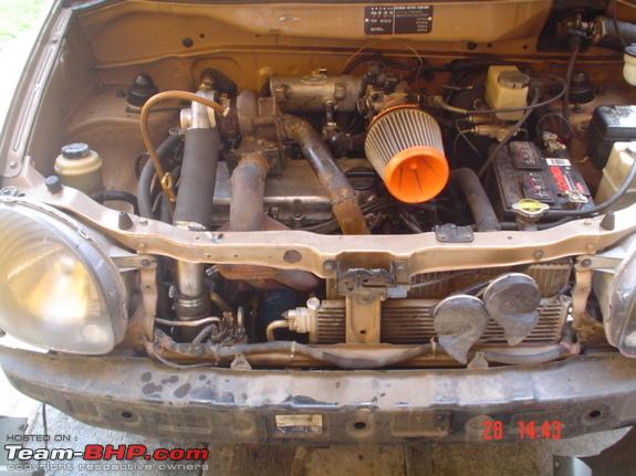

Anyone willing to try this on their Santro?
Please let me clarify, this is not mine ... source is goolge "santro turbo" and some latin site.
This seems to be a very bad home made DIY turbo.

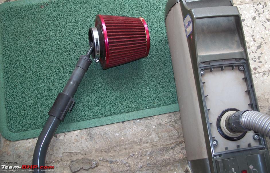

4) Now, Use a vaccum cleaner, and keep it on blower mode. Put the smallest tip at your blower end, which can blow air, with maximum force.
If you dont have a vaccum cleaner, go to a mechanic, where they have this pressure, air cleaner. Just blow air, keeping the filter a bit away from the tip of the blower.

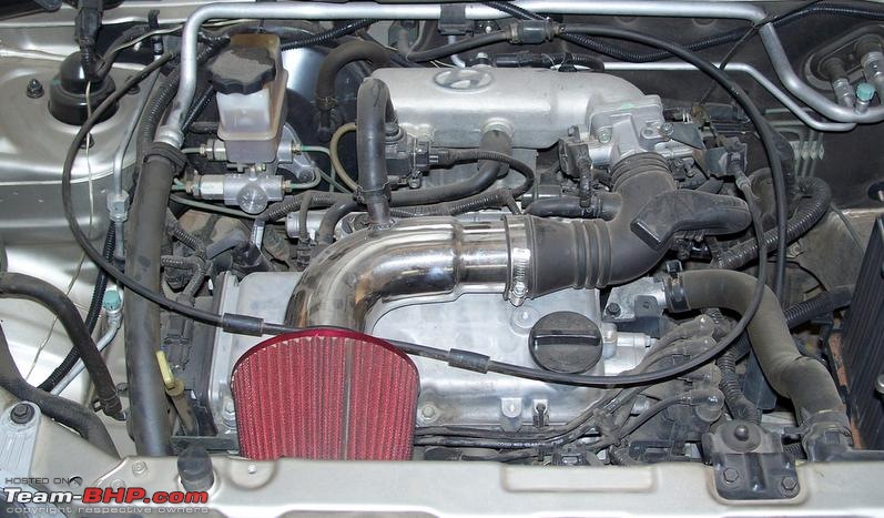

From the pics of your filter looks like the engine will be sucking in a lot of hot air. I was facing problems before with similar install and after i changed the piping and position that is away from above the engine there has been considerable difference in the running.
Adi
