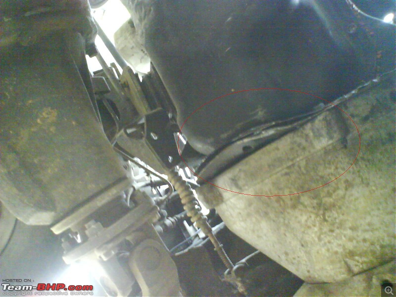

Nissan Engine
and Gypsy King geabox mated to the engive via adapter plate.

Hi, nice job, The adaptor plate looks .. Can I have a slightly bigger picture of the same?

Could you please post clearer pics of the adapter plate : it seems bent in certain places.

As requested in earlier threads I will post some more pics of the adapter plate once I get under the car properly. I am not sure how much help it will be a you can hardly see it anyway. I will make it a point to try and remember to take pics of it at the next clutch change when the grearbox will be taken off (have run 42,00kms on the current one). Think that will be more helpful to everyone.
