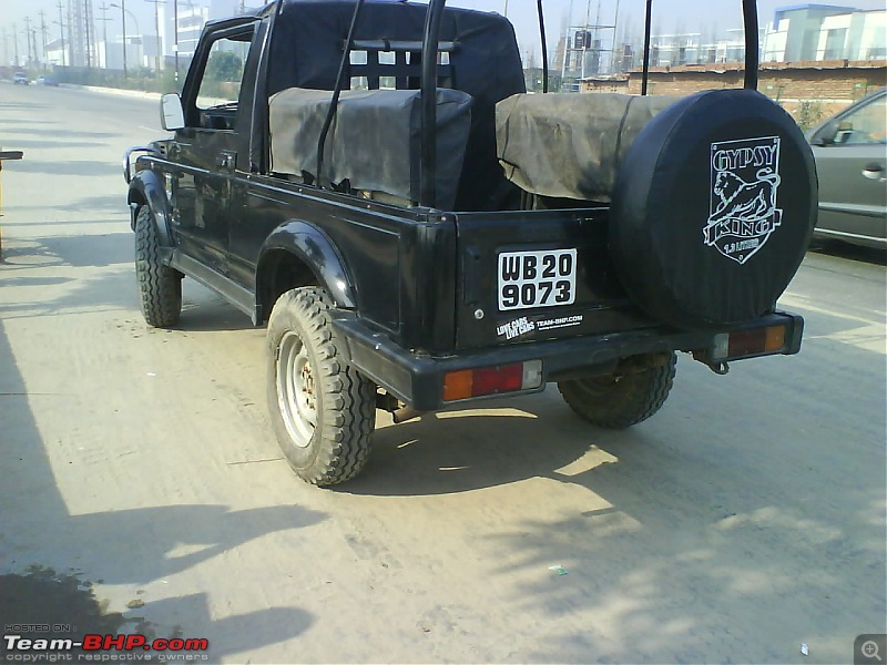

Hi all
I have completed 10,000kms on the diesel engine. The engine is running well and the vehicle is performing well on OTRs.
I had to get the following done:
  1. Change to a larger radiator as the engine used to overheat in 4L in summer OTRs (INR 3K)
  2. Get the fuel pump reconditioned as there was power loss when climbing steep slopes in the last few months (INR 4.5K)
Since the fuel pump re-work I had not attended any OTR till the NCR OTR on 1st Nov when the power surge not only surprised a few Mods but also suprised me. I am very happy with the engine performance now.
The problem I face now is mainly loss of traction, although since I have changed my HT radials for F78 this issue has improved vastly. Since the trails here can be very steep, sandy and bumpy (all at the same time!!!) it gets tricky keep traction. I am planning on installing auto-lockers on the rear diff. Any suggestions regading this would be very helpful.
Also, I have asked about MT tyres (non-directional) on the tyres and rims thread. Any suggestions there would also be very useful.
Thanks
Ankit
PS: OTR pics credit Married2Speed

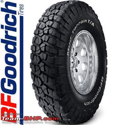

Did a bit of research on the types of Mud terrain tyres I can use. The following tyres are available in Delhi as I have seen them on NIOC jeeps. Just need to find the correct size i.e. 215/75 or 235/75 R15s.
Any feedback on these would be very helpful.
Tyres in pictures from left to right and then down:
Pic 1 - BFG MTKM2 size 235/75 R15
Pic 2 - BFG MTKM size 215/75 R15
Pic 3 - Kumho LK71 size 235/75 R15
Pic 4 - Maxis Buckshot size 235/75 R15
Pic 5 - Bridgestone Duellet MT size 9.5 R15 (?? what size is this)

On stock gypsy rims, you can fit at the max 215 75 R 15. Go for yokohoma AT/S. or Michelene. Maxxis is the MT and it requires alloys since they come with minimum of 235. BF Goodrich is a good tyre, but will be too bumpy as it is hard compound.

I have been using BFG MTKM size 215/75 R15 for a year now, i would suggets you to go for this tyre because we have driven it around 20,000 kms in Mud, Dirt, Highway, Jungles, mining roads etc. Its performing well without a signle puncture over a year. I sourced it from Allahabad.

235 DO touch (like a mm or so) on full lock and during articulation it is dependent on the suspension setup.
I would suggest 215 as the optimum size. BEST SIZE IMHO for all needs -- daily drive + OTR's
