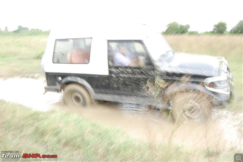

I own a 1996 Gypsy King. It was a 1.3L carb model and one of he first batches of Gypsy Kings. It had the original factory fitted hard top and we had got the 2 long bench seats at the back replaced with front facing seat. We had got AC fitted to it as well. Even at close to a lakh Kms the engine was as smooth as ever and the 4x4 worked well... not that I had got a chance to use the 4x4 for the past few years. It runs on 215 75R15 Goodyear Wrangler on front and Maxis on the rear.
The vehicle was in Kolkata and I brought it to Delhi in 2005 and had CNG fitted (hated driving it with CNG). I used it for daily commute for close to a year. In 2006 I bought a Ford Fusion for a more comfortable family car but kept the Gypsy as well.
Now the fuel prices have nudged me in to converting my Gypsy to diesel as I did not want to queue up for hours to fill CNG. The most important priority for me was to retain the 4x4. After a lot of confusion and research I got the Nissan 1.7L diesel engine fitted, mated to the Gypsy King 5 speed gearbox. I was more inclined on the Toyota engines but my mechanic suggest against it as they are heavier engines and Gypsy is a light vehicle… plus he swore by the Nissan plant. The work was carried out in Mayapuri (New Delhi) under the supervision of my trusty mechanic. The suspension had to be raised to ensure adequate gap was maintained between the front diff and the sump. The power is 55hp @4800rpm and Torque is 10.6KgM@ 2800rpm (stats kindly provided by Jeepgeorge - thanks). The power on tarmac seems to be nearly the same as the 1.3L carb unit and the fuel economy is close to 18kmpl without AC and around 15kmpl with AC. I have been told that on a Gypsy the non AC economy should go up to around 21kmpl.
I now use it every day to commute to work and the Fusion for weekend city drives with the family (wife and 4 month old son). I have done some light off-roading using the 4x4 and all seems well. I now want to get involved in a bit more serious off road action to test its abilities. I have also retained the old AC unit but it may need changing as it is also 12 years old and is quite ineffective in peak summers. I am getting the hard top removed and a soft top fitted over the front 2 seats. The 2 long bench seats at the back are going to be fitted again. A set of Hella’s for the front bull bar has also been ordered. I am also thinking about a twin cab hard top conversion before the onset of summers next year.
I will post some more pics of the engine and the new soft top look when I get it from the workshop.

The second pikchaar is nice. But, I still think you should have put in something faster.
Why do you want to spend on the soft top when you will get the twin cab thing done anyway??

The car look good the same way as it is in the pick.If possible would suggest you to add some alloys wheel's to it they will look realy cool.
Well, the soft top will cost peanuts compared to the twin cab converion and if the A/C works fine in the 2 seater soft top I may not go in for the twin cab conversion.
