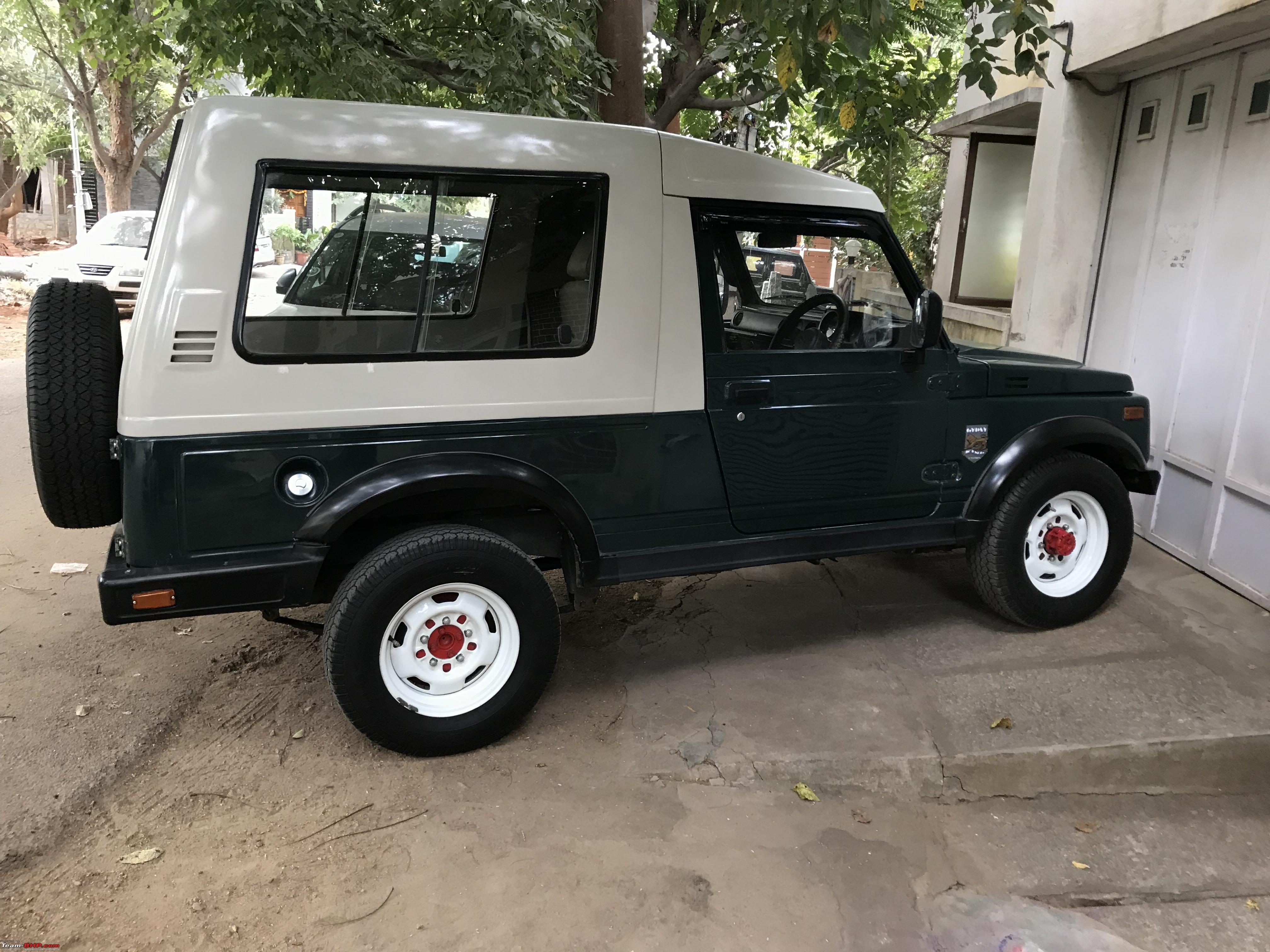

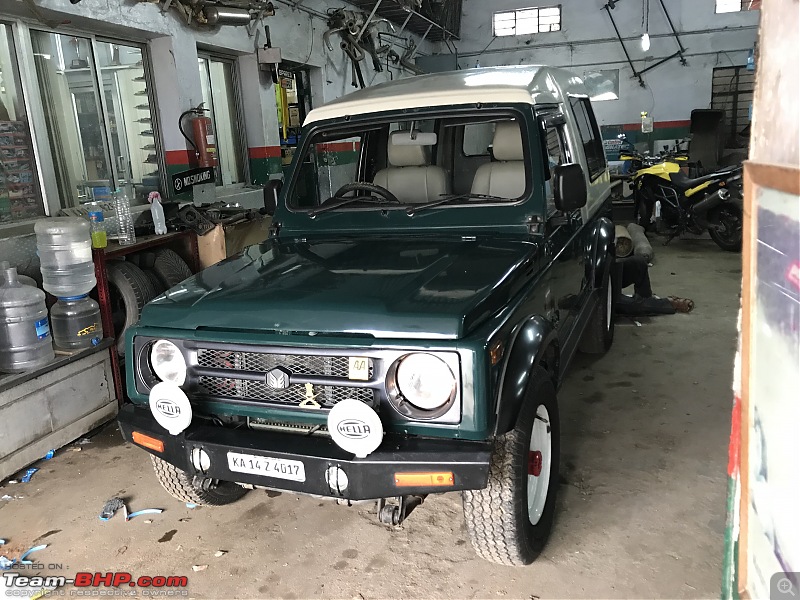

The poor old adopted beast after its first bout of restoration work. All oils changed. Engine Flush done. Various smoothening additives added in the engine and both gearboxes.
There is a lot more of work to be accomplished including some tinkering and things.
But it is slowly coming back to life....
shankar.balan is offline   (5) Thanks

It looks great Shankar.
Looks like a new paint job as well. White rims are looking classy. If you don't mind sharing; how much did the paint job cost? Was any work done on the suspension?
Vikram Arya is offline
Old 8th November 2018, 23:53   #475
Posts: 11,797
Thanked: 27,232 Times
Infractions: 0/3 (13)
Re: Maruti Suzuki Gypsy - Queries
It was bought in this Green shade and Khaki top. No paint job done at my end.
I ll say one thing for the Gypsy - it is a highly photogenic beast!
The white wheel rims and suspension setup including the leaves and Monroe Gas Shocks and the AISIN FWH hubs etc were a straight lift off and switch over from my White Gypsy and placed on this Green one - because I wanted a stock Gypsy. I had actually had those white rims painted in 2016 at a price of about Rs 650 per rim....even my own Goodyear Wrangler Tyres I hijacked from the old White Gypsy and shod onto this Green Gyp.
Originally the Green Gypsy (when I saw it) had CFLs and Shackles and fat tyres and off road rims etc, none of which I wanted.
The dealer/ previous owner had re done the bonnet paint for me because that was earlier in a mess.
Otherwise, I have only begun the restoration work now, by getting things like the under chassis bump stops fixed, cleaning the throttle body, adjusting the timing, engine flush, radiator flush, changing all the coolant and oils and stuff. Ive gone for Fully Synth Shell Helix 5W40 for the engine plus XADO revitalising additive to restore the metal bits.
And Liquimoly additive to the main gearbox plus Xado Gel for the 4WD gearbox. Both differentials oils and both gearbox oils were changed to Shell Spirax. I changed the broken engine cooling fan. And did a little bit of electrical part changes like the lights and lenses etc. I also chucked out the old gear box bearings which were noisy and changed them over to new OEM ones. We changed the clutch releaser bearing too.
We have to do some tinker work beneath the Gypsy because the cross sections beneath the running boards etc are rusted. We also intend to change the exhaust to a sporty mildly growly one.
So far so good.
Basically the only reason I went for this Green Gypsy was the KA registration because my White Gypsy had an UP Reg and I wasn’t able to get the NOC. Of course, I always loved the Green and Khaki combo much more than the plain white. I ve had three plain white Gypsys in my life so far in the last 21 years. This is the only time I ve actually found and managed to get a Green and Khaki.
But I have a lot of work left to do, before it is brought back to near-scratch.
Lots of money to be spent as well, because things are expensive and Gypsys tend to eat a hole in one’s pocket as one keeps fiddling with them....
