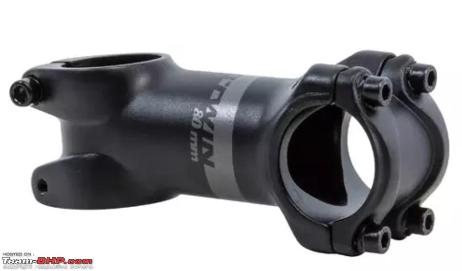

Custom stem I bought from Decathlon:

This is not ideal, to mitigate this problem, I bought an 80mm stem from Decathlon which is slightly shorter than the stock stem. I think the stock stem is 100mm. The Decathlon guys informed me that it is a direct fit for RC100 bike. However, that was not the case. More on that below.
Once I received the stem, I went to my nearby cycle shop for the stem change.
If you have RC100 and you want to upgrade, there are quite a few things you need to keep in mind. RC100 comes with non-standard road bike gears. As a result, swapping requires some kind of jugaad.

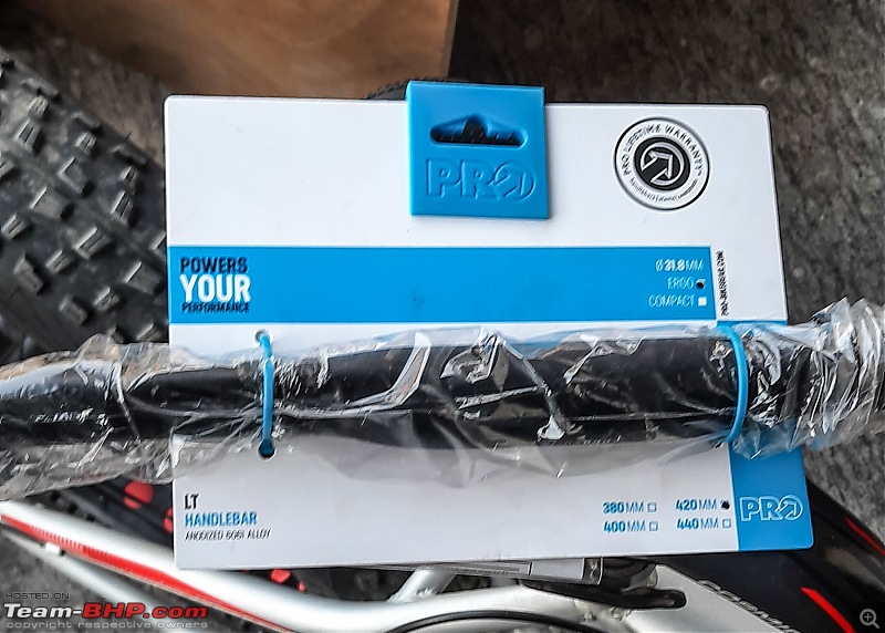

Problem 2: (Stem and handlebar compatibility)
The 80mm stem I bought is not compatible with the handlebar of the bike. The diameter of the handlebar is smaller than the stem. As a result, I have to purchase a handler bar from the bike shop (Shimano handlebar) which has a flat top. This was an unexpected expense. It also shows that do not take the Decathlon guys' words as a gospel.
New handle bar Wallet damage: Rs: 3500

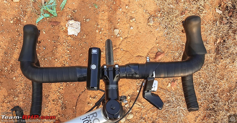

Problem 4: (Gear shifter and handle bar compatibility)
This was a huge hurdle. Since the new Shimano handlebar has a flat top, placing the gear shifter was a problem. Gear shifter clamp was originally designed to fit in the small round handlebar. After some discussion and checking, finally the mechanic was able to find a big clamp and a big screw.
The big screw and the improperly fit handlebar tape is an eyesore for sure.
Similar custom screw that was used to fit the gear shifter
As you can see, the handlebar tape is not properly attached to the bike, but it is understandable since we have added a custom long screw to the gear shifter mechanism. After the Frankenstein job was completed yesterday night, today I rode some 24KM and so far so good. I have not faced any issue.

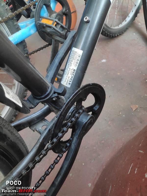

I bent my crank on a speed breaker
I went to decathalon for a spare
However they said it could take upto 2 months
Instaed they adviced me to source the spare
Can someone help where I can by a spare
In South mumbai or online
Bike is
Riverside 120
36 spoke crank

If not, a competent cycle-wallah should be able to straighten it. I do this quite regularly.

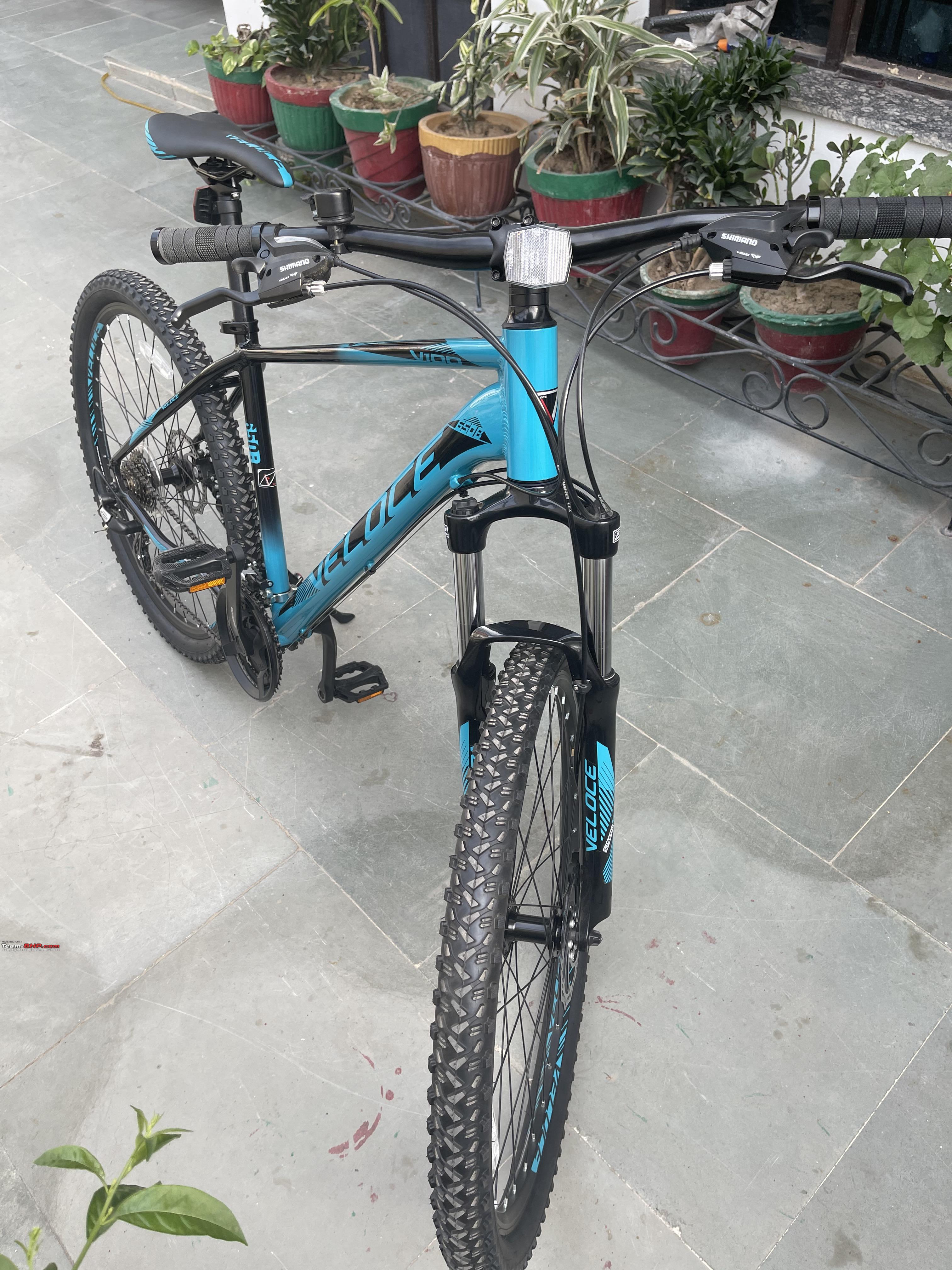

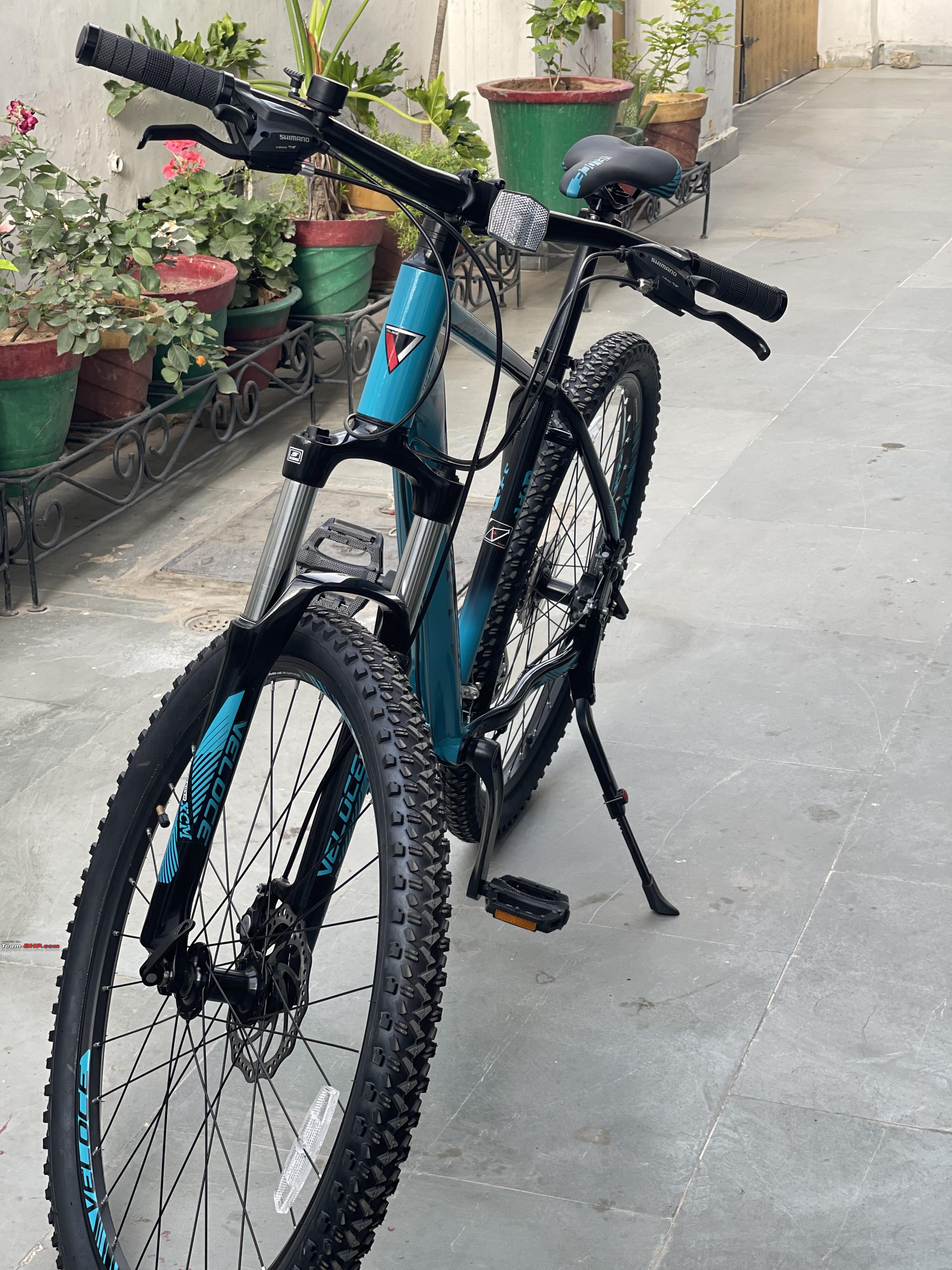

A big thanks to our very own Doc (ebonho) for helping me finalize the perfect starter bike for my better half. It is a very simple bike with good starter components and a very smooth ride.
Specifications:
Frame – 650b” Alloy MTB Frame
Fork – 650B Suspension Fork, Travel 120mm
Frame Sizes – S, M
Speed – 21 SPD
Headset – Head Set, Steel Full Bearing Ahead Type, With Veloce Logo
Top Cap – With Veloce logo
Spacer – Alloy Spacer 5mmx5 Black
B.B. Set – Cartridge BB 122.mm
Seat Bolt/Pin/Clamp – 31.8mm, Alloy with QR
Drivetrain
Shifter Right – ST-EF500-7R, Right 7-Speed
Shifter Left – ST-EF500-L, Left 3-Speed
Front Derailleur – Shimano Tourney
Rear Derailleur – Shimano Altus
Accessories: Bontrager side stand (1600/-)
More information is available here
Customary pics:

Looks good. Congratulations!
Finish and components are really good. XCM is a level up from what you get in tjis price point. But no lockout is a downer.
What's the actual weight of the bike?

Thanks Doc! Fit & Finish and Suntour XCM suspension are indeed a level up in this price bracket. Sadly, there is no suspension lockout but I guess that's something my wife is okay with, for now
The total weight of the bike is 15kg (Including the Bontrager side stand)

There is saying in Marathi, "Naalisathi Ghoda", loosely translated to getting a Horse for a horseshoe. Not sure if you checked the details of handlebar diameters. There are 2 ISO sizes, 25.4 mm and 31.8 mm. As per these the handlebar and stem compatibility can be checked. I think rather than relying on the word of decathlon, you should have checked the diameter of handlebar. It would have avoided all this hassle.
Did you try local cycle repair shop? Not sure if you can find these in South Mumbai. I met an accident where the chainring was deformed. Just visited a local cyclewala who straightened it for 20 rs. Obviously it wasn't restored to factory fit but it is working fine.
