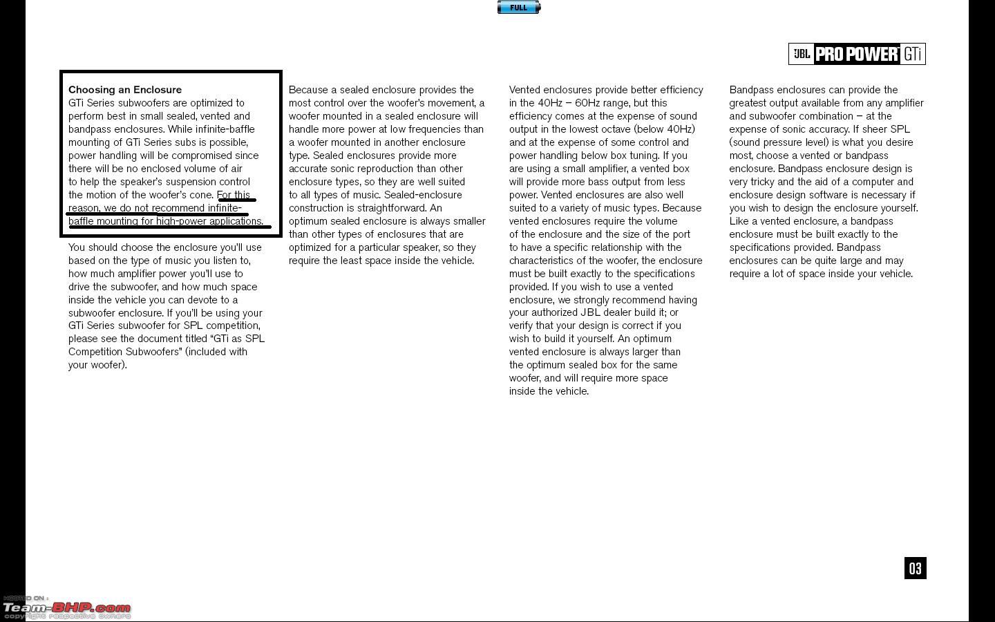

ok here's the thing.
The Dilemma of the Low_Bass_makker/s?-untitled.jpg
so according to Pro Power, the sub must not be placed in IB configuration. I have read on many forums online, but no one recommends the IB config for this sub.
Thanks mate, saw the reply.
About info on forums, you could read the first post here....there are more threads on that forum but I was too lazy to search them out
DIY Mobile Audio
Just my 2 cents worth on the attachment you posted - the PowerPro guys are not wrong really, but they only caution that the sub will handle less power in IB vis a vis inside an enclosure...well, this statement is true for ANY sub. In IB, a sub will anyway need lesser power to achieve full excursion (gurus, please correct me if I'm wrong) so I dont see that as a big issue unless you enjoy taking risks with extra amp power
The statement does not indicate whether SQ will be better or worse in IB....from what I've read, suitability for IB has more to do with TS parameters, especially Qts which seems suitably high in the case of the WGTI.
Anyway, proof of the pudding is in the eating - hope I get a chance to listen and find out some day.
Yes all subs are more easily driven to max excursion in IB compared to sealed.
However some subs are more suspetible to be driven to damage in IB. I am given to understand (talking to some other car audio guys) that the JBL is not very suspetible and can handle quite a bit of abuse as can be seen in the video below
that said the place I would start would be here.
http://manuals.harman.com/JBL/CAR/Bo...2GTi_rev_f.pdf
I would consider the 1 cu. f.t sealed and 2.2 cu. ft. ported options keeping ni mid that these volumes are net volumes and the volume required by the woofer also has to be considered.
There is however NO reason why an IB install cannot sound just as good as a ported/sealed box. One just need to be more careful about the tuning.
actually sir on most forums online ive heard that the GTI series do like IB however though most people use the W15GTI in IB - heres a picture of one such typical IB install
