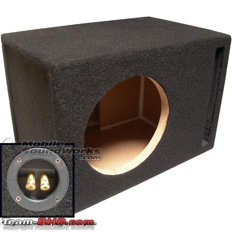

why there is jarring on some songs (mp3 songs 320kbps file), these songs use to play absolutely fine earlier, just off late they have started jarring,
I have put a new as per Jl audio specs MDF box with a side cut for the air to pass, it is a monster woofer, all as per the Jl manual.
1. check the surround (the rubber edge around the cone)
2. block that hole in the MDF box.
report the findings and lets see.

Navin, could the "side cut for the air to pass" be a rectangular port by chance?

As per Jl manual
Below is the pic of the box the way it is in my car. i have picked up sample pic but mine is a ditto copy.
Car Audio Advice from the Audio Gurus: Use "Search thread" before posting a new Q!-jl-box.jpg

1. A port in a box is tuned to reinforce the bass. It does so by creating a helmholtz resonator (the port functions as the “neck” of the resonator and the box functions as the “cavity"). Ported boxes are more efficient (go lower and play louder than comparable sealed box designs) but suffer from 2 issues. (a) the driver's parameters are very important - a sealed box is more tolerant of variations in driver (T/S) parameters) and (b) below Fb (box resonant frequency) there is no resistance offered to the driver hence if the speaker is driven hard below Fb it can loose control and hit Xmax limits very fast. A sealed box offers resistance to the driver across the entire band of frequencies so will not allow the driver to de-couple and hit Xmax as easily.
2. If you want to prevent the box from "walking" you can velcro it to the carpet in the trunk.
3. take the amp outside the car and test. see if the settiings still change.

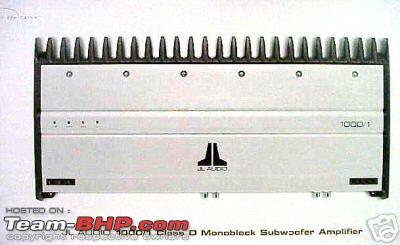

- 4 components- JL audio (don't remember the model number)
-Blaupunkt 4 channel amplifier for the speakers.
But do you think HU can be an issue here with whatever I mentioned in my last quote? is pioneer 4150 better (just for my info). The idea is to rule out things one by one, though last night after this observation think it is the HU, that is the reason i am asking (i could be wrong).
Jl Audio amp 1000/1 pic below:
Car Audio Advice from the Audio Gurus: Use "Search thread" before posting a new Q!-jl-amp-1000.jpg
The Saint is offline
