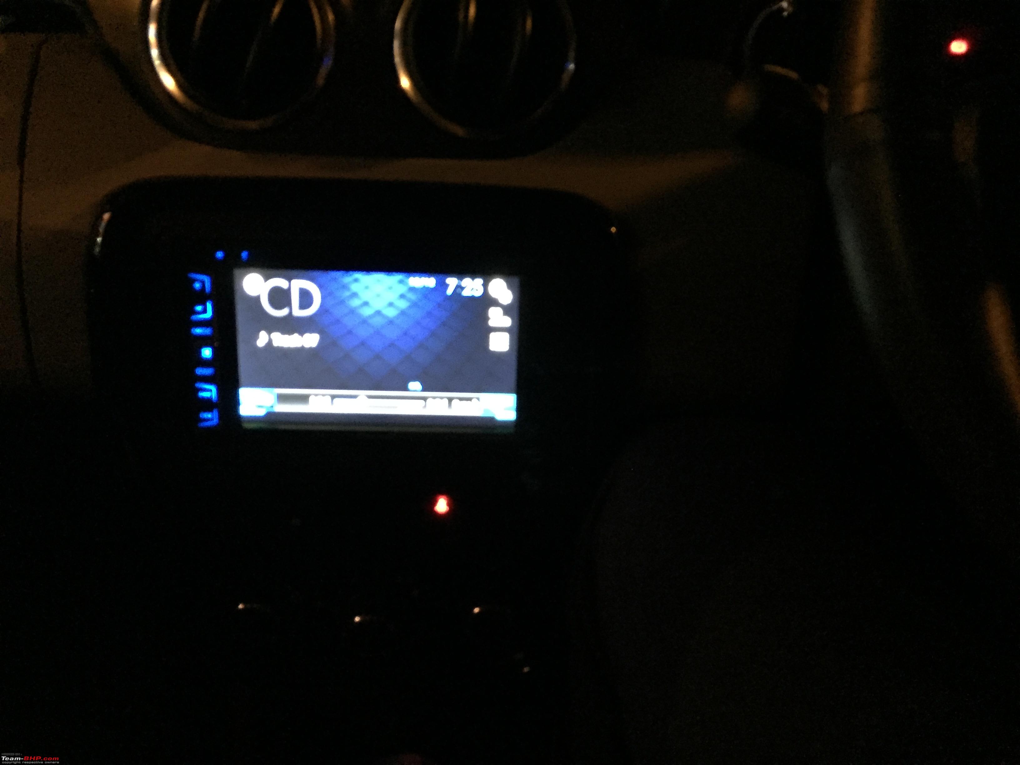

You can look at pioneer 2790bt, I recently got it installed in my duster. I bought it from snapdeal for 16833 and it does have cd, usb and aux. I did install reverse camera with it for 1.5k. In my case I needed a steering control interface so that cost extra. Attaching a pic for your reference.
Car Audio Advice from the Audio Gurus: Use "Search thread" before posting a new Q!-image.jpeg
soumen.blore is offline   (1) Thanks
