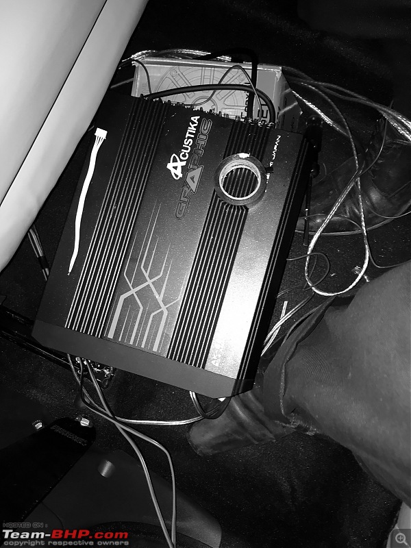

What is the feedback for acustika 4 channel amplifier .One of my friend suggested this to me but I have never heard about them before , attaching a picture for reference although it's not clear .
Car Audio Advice from the Audio Gurus: Use "Search thread" before posting a new Q!-image.jpg
