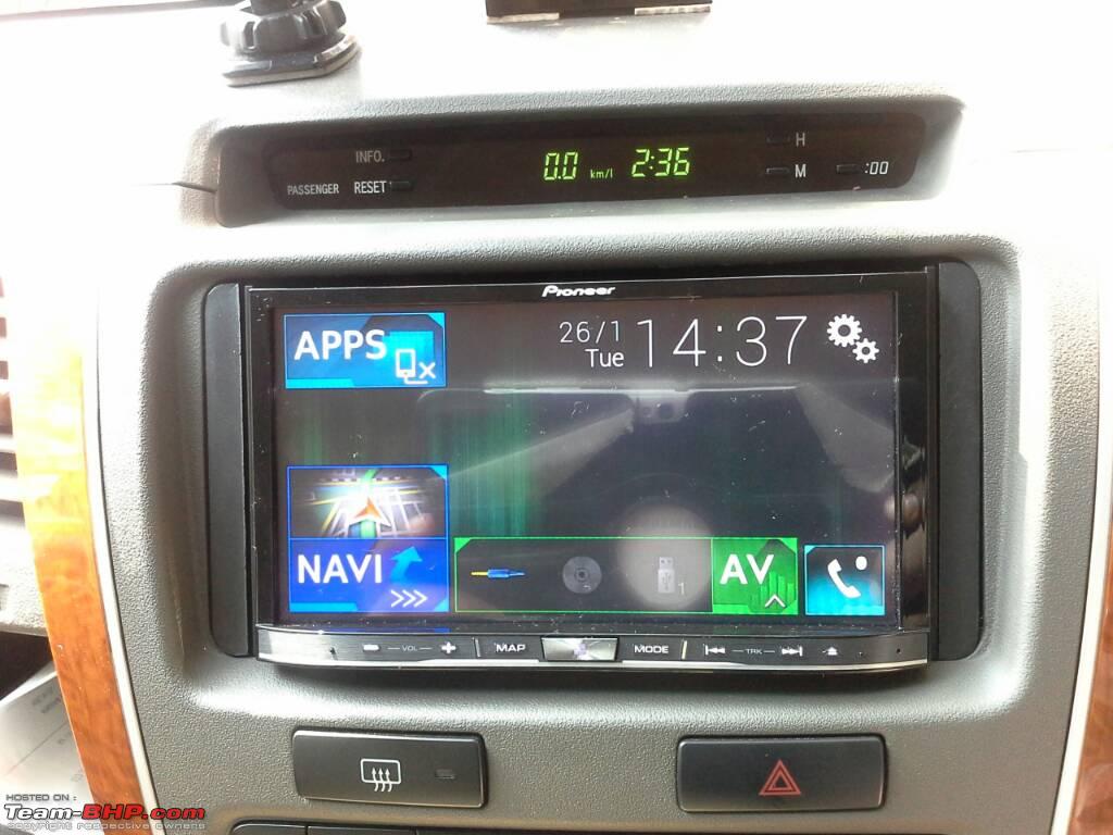

Last week changed my CASKA head unit in my Fortuner with
Pioneer Avic-F70 BT. Initial impressions seems positive. Tried Mirror link /Android Auto with my Galaxy Note Edge. No success. 😕Trying to get the original Android kit now.
Attaching Pics of the same..
