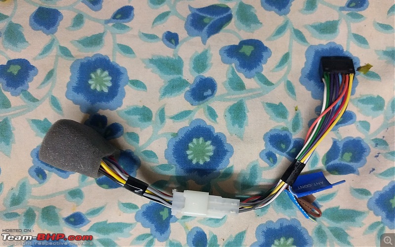

Finally arranged a coupler to coupler harness for connecting the JVC HU with the harness provided in my Ritz. Seems to be a good buy at 500 bucks from a Maruti dealer.

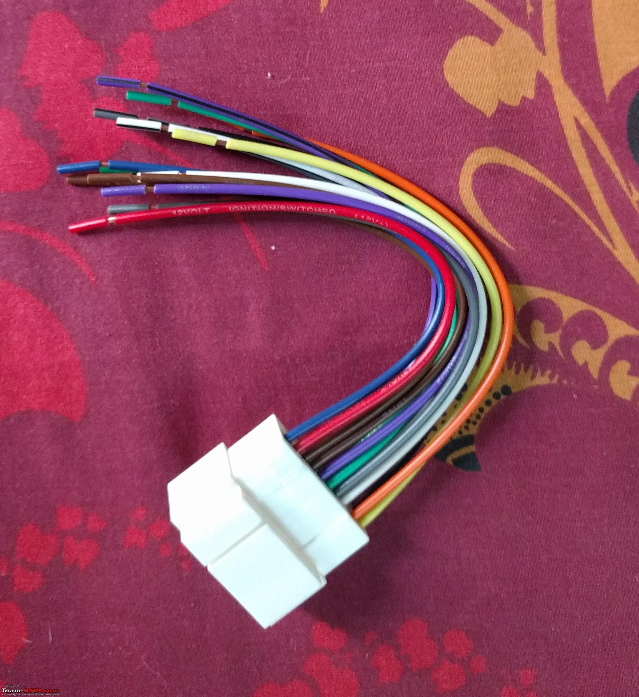

For everyone who's looking for a high quality(Scosche) Head Unit to car wiring harness coupler for Maruti Suzuki cars(Swift, Ertiga, Ritz, etc),
Please find the link here:
http://a.co/5iGKK9u
Thanks
Aditya
