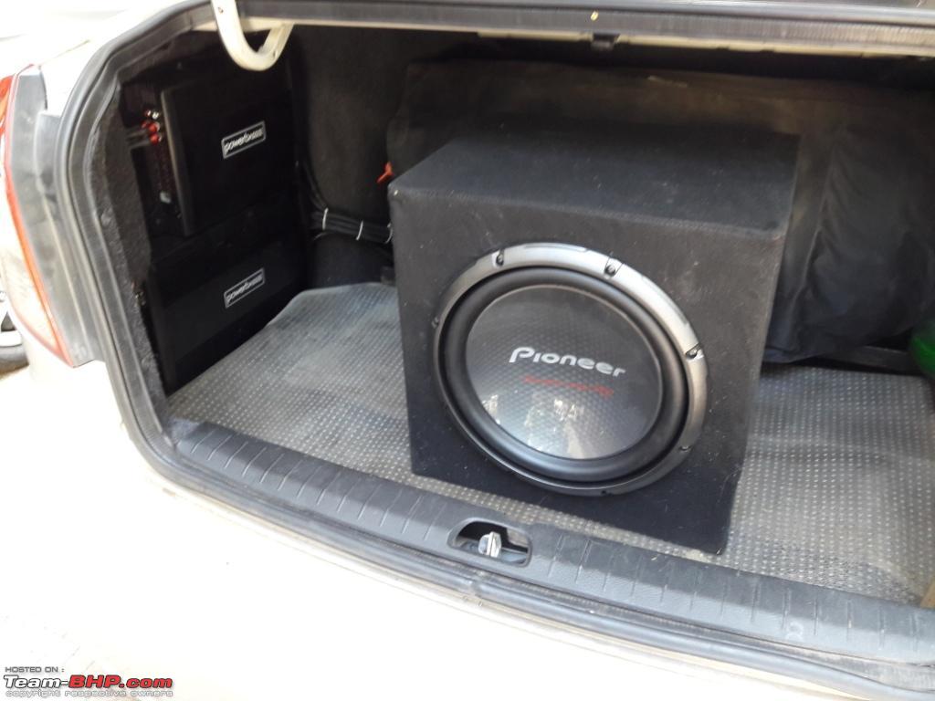

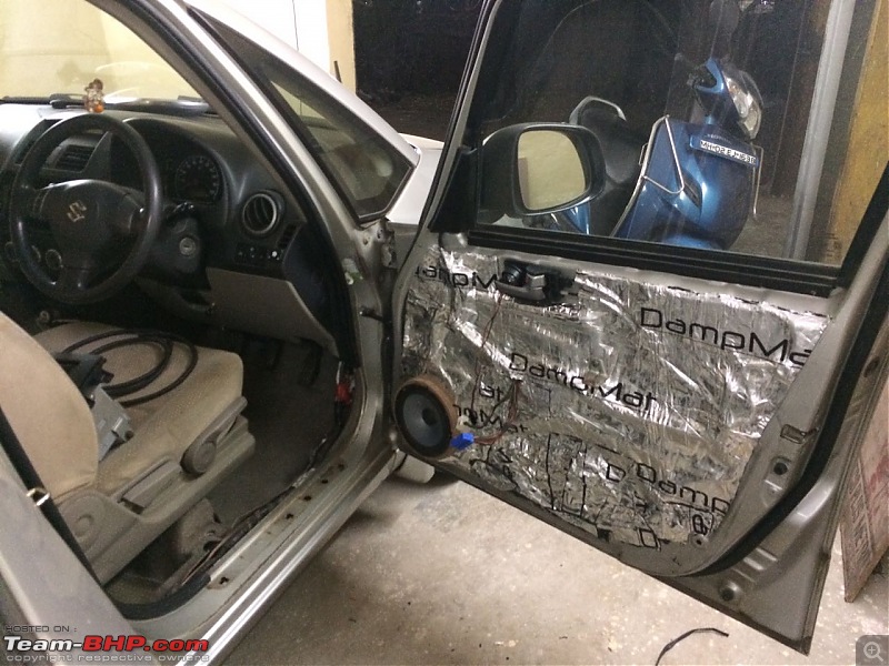

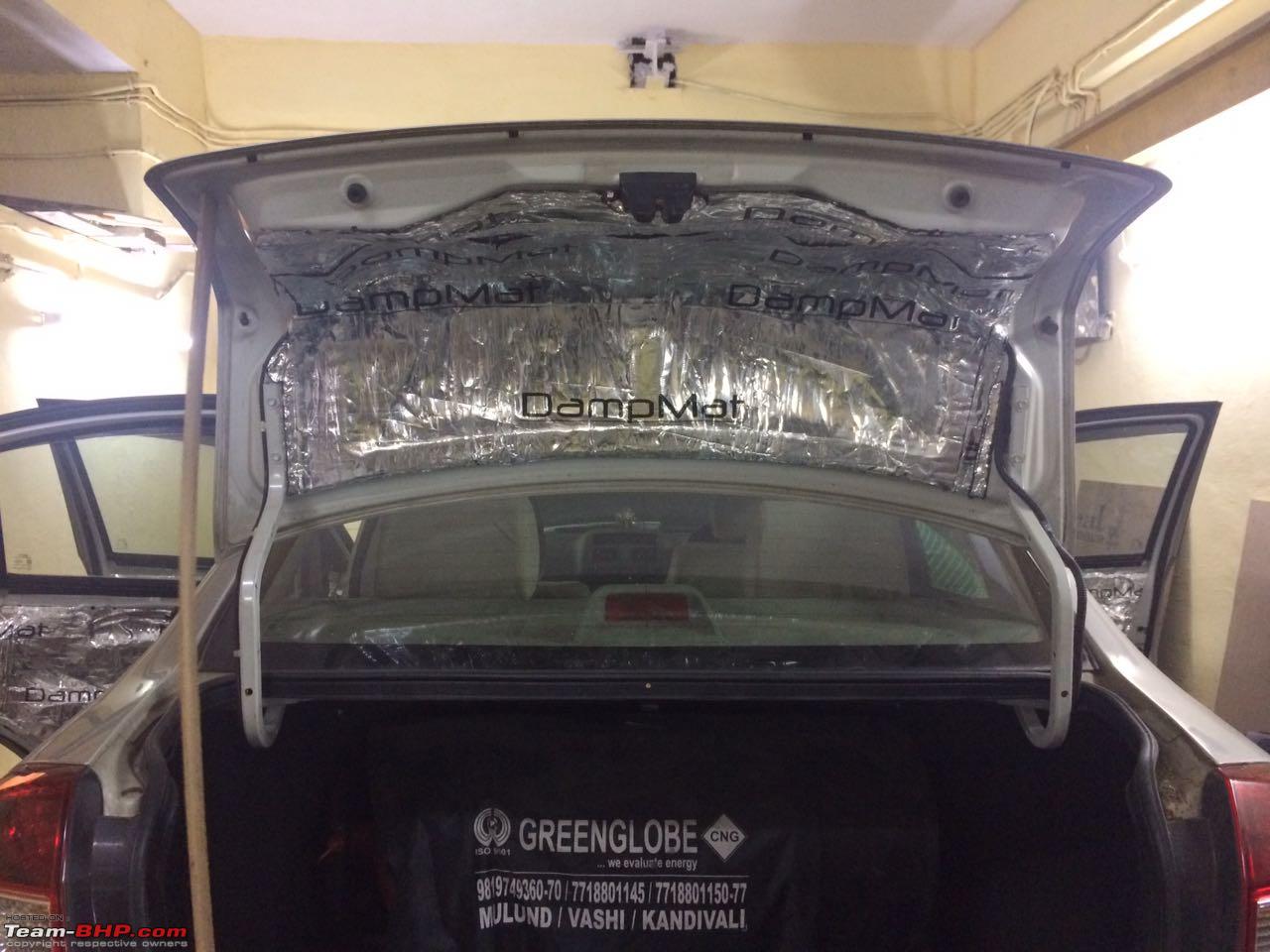

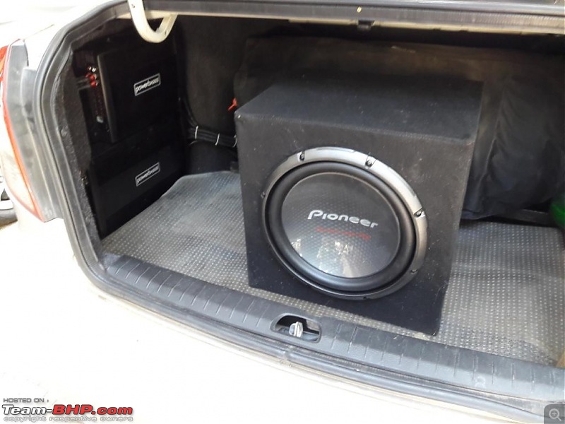

Here's my system installed by Soundfactor.
