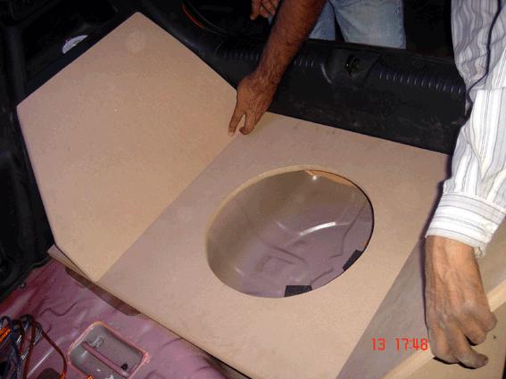

New Floor fabricated out of MDF. Being checked for measurements. This is where it gets interesting.
Angled side panels being positioned to test angles are correct and as per measurements.

2. The 15" woofer is sitting in the spare tyre location.
A: The owner made it clear he had NO intention of using the boot, didnt need the spare. He wanted the sub to be visible. Optional hex hole grill is available though if he ever wants it.
