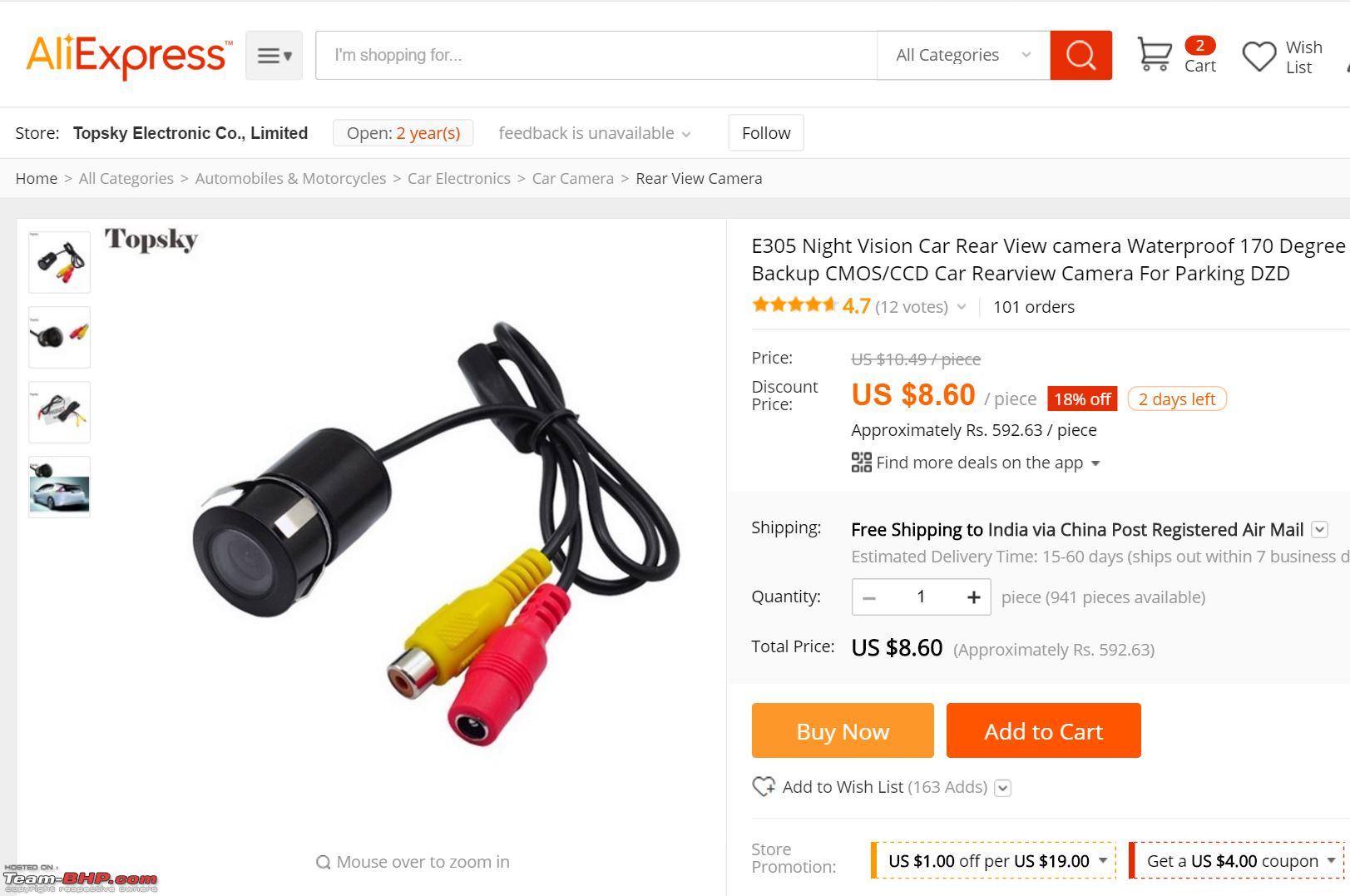

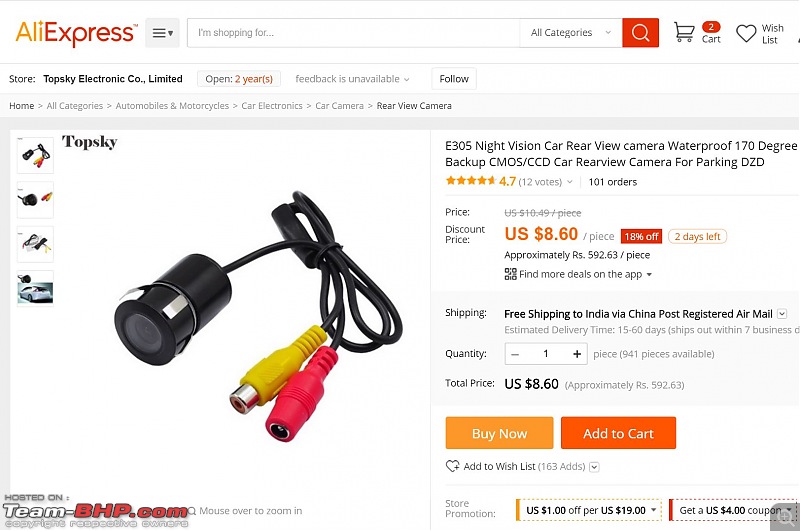

Thank You. I'm sure with God's grace and help from knowledgeable members like you will ensure my DIY goes smoothly without any problems as I'm a total noob to DIY
I got the model which has a display for the rear view camera along with the auto dimming function. I'm still undecided about the camera, Could you or other knowledgeable members help me out with that as well?
I've attached pictures of the IRVM I bought alongwith the camera I'm planning to buy. I wanted to buy a night vision camera without any LED lights, though I'm confused how do the night vision camera without LED lights work. Could someone shed some light on that as well? Thank you
DIY Install: Auto-Dimming IRVM & Anti-Glare ORVMs-aliexpress.jpg
DIY Install: Auto-Dimming IRVM & Anti-Glare ORVMs-nightvision-camera.jpg
