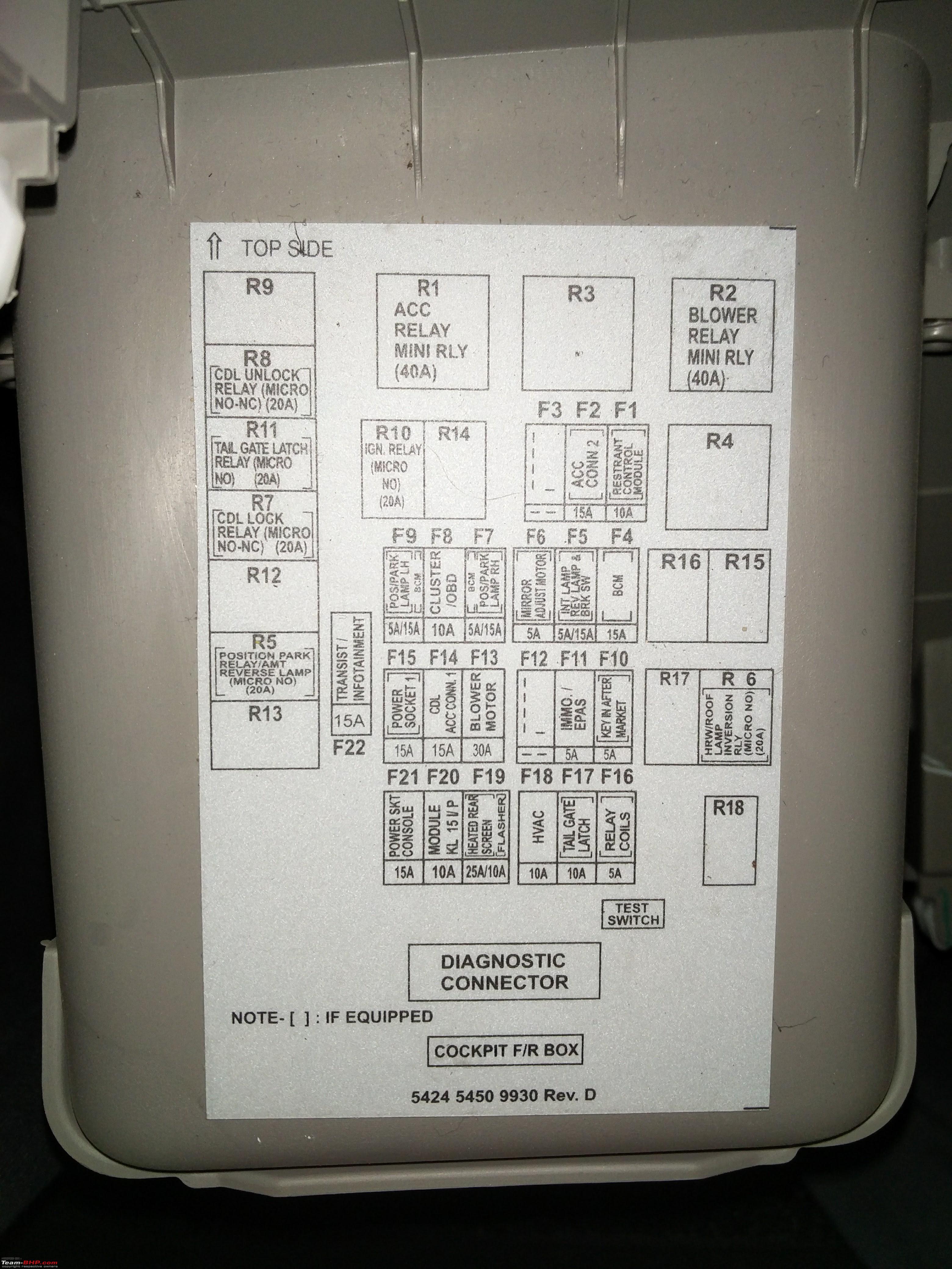

Hello, how have you done wiring in the Tiago? Fuse box or somewhere else? Also which fuse if you've used the fuse box.

I used the fusebox. I believe I used F12 fuse. Can't remember exactly. I'm going to hardwire my air purifier and a dashcam soon so can confirm again if required.
DIY Install: Auto-Dimming IRVM & Anti-Glare ORVMs-img_20171118_114045.jpg
