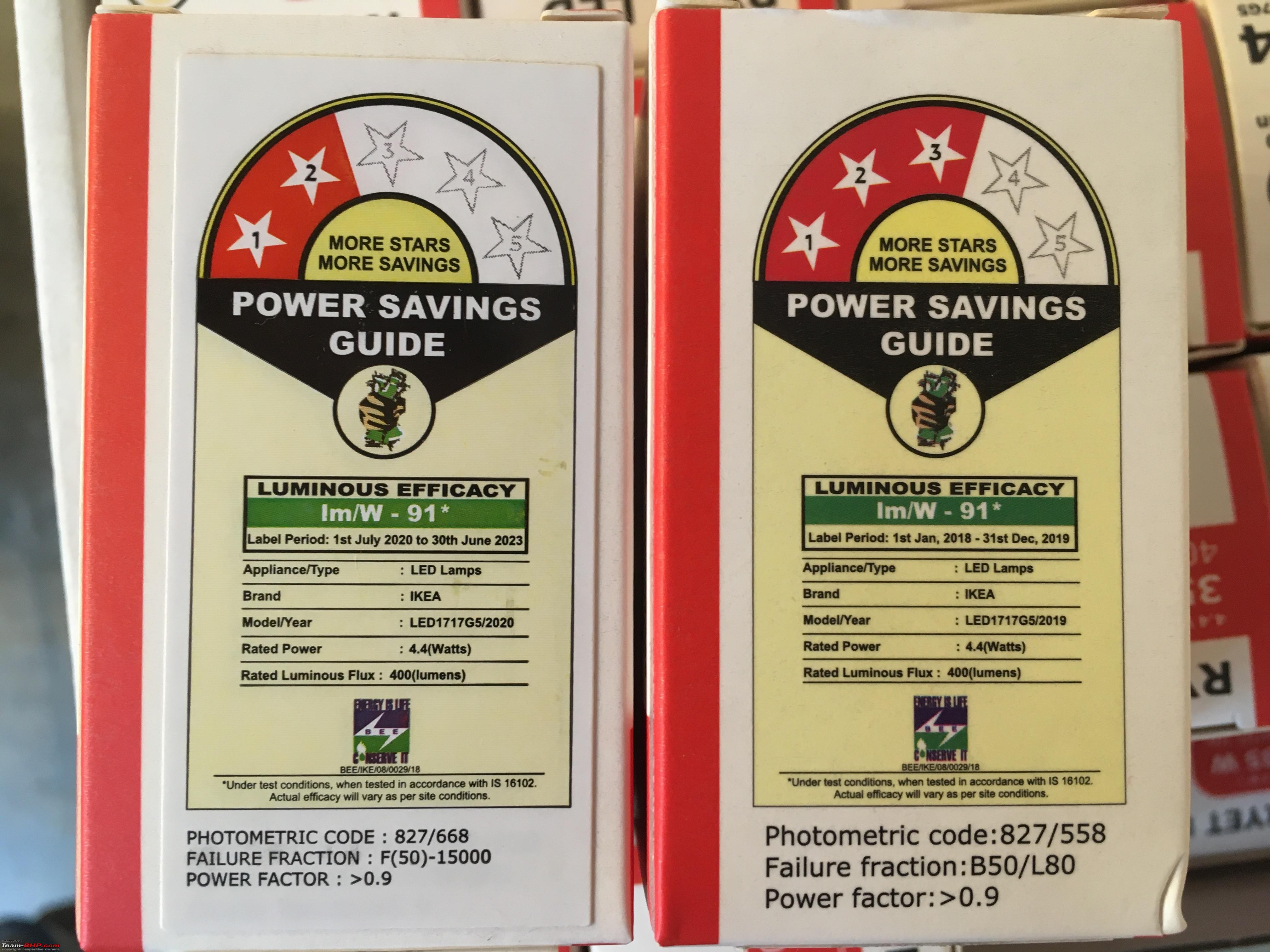

Photo from around October 2022: Two identical IKEA lightbulbs, but different rating validity period = different star rating.
I assume the test criteria change every few years.
Besides that, the test conditions and rating criteria for different styles of the same broad appliance can be different. I am fairly sure I remember reading that window ACs have more lax criteria than split ACs. Could be similar for different styles of refrigerators (but don't quote me).

Thanks yes I am hoping the measurement of annual units of electricity consumed is different, however I am not able to get any information to confirm this. I have never paid any head to star ratings even when it comes to the safety of cars, but I always make it a point to read the detailed reports and in this case the only details divulged are units of electricity consumed annually and my problem is that there is a huge difference in that number itself so if I could get some confirmation regarding whether or not they measure those units differently now compared to how they did so back in 2017, then that would put my mind to rest. Currently I am finding that there is an atleast 20-30% jump in the annual units of electricity consumed numbers that are published.
