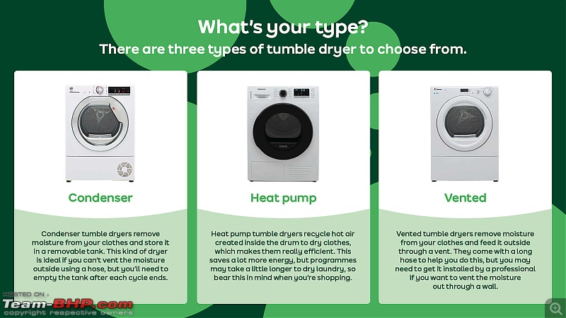

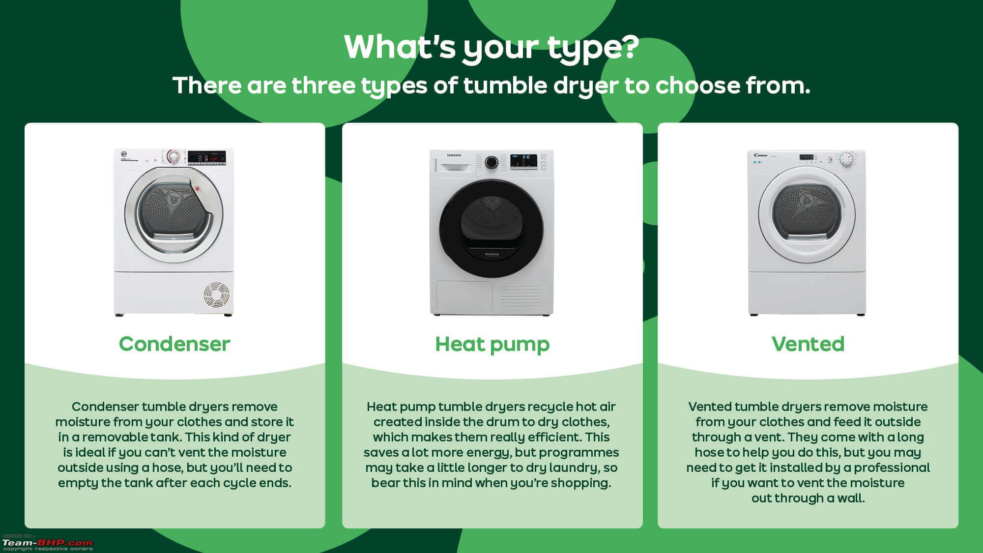

Living in a place where there are only a couple of weeks a year when outside drying is not easily possible, I haven't even thought about driers for year. I have not heard of a "heat pump" drier. I have heard of a condenser drier, which needs no vent. Similar? Different?
They're not the same. I guess the easiest analogy is a vented dryer is essentially like one great big blow dryer (like you have for hair), the moist air is ducted outside.
A condenser dryer is the same as above but instead of just immediately ejecting the moist air, it has a condensation tank to try and extract some/most of that moisture.
At it's simplest a heat pump is what you have in your fridge or AC, it's a heat exchanger. In a heat pump dryer it's using the heat exchanger to maintain the temperature in the drum instead, meaning you don't constantly have to reheat fresh ambient air to higher temperatures to then input into the dryer. Thus you can have lower drum temperatures and significantly lower energy use. The caveat lies in increased time to dry and initial outlay.
That's it really. At the end of the day air drying is best but if needing to line dry indoors, and you don't want that mildew-y smell, you'll end up needing some kind of dryer. (Another caveat is that if you're needing to regularly tumble dry your clothes, heat pump dryers are much gentler on clothing, because of the lower temperatures).
The Home Appliance thread-tumbledryerbgtypesdesktop.jpgLink
On a wider note, part of me wonders if at least in northern & north-eastern India there's room for air source heat pumps as part of integrated HVAC systems for homes (not sure how much heating demand there is in winter), but that's a separate and much more involved appliance so to speak.

Thank you very much for your very full reply and explanation. It will benefit everyone interested in these machines.

All condenser dryers have a heat exchanger. Heat pump dryers are just a subset of condenser dryers. If you take off the panel at the bottom of the front of your Siemens unit, unlock the two tabs and pull the handle, you will find a large heat exchanger there (beware of water). The difference with a heat pump is that after the hot, humid air passes through the condenser fins where the water condenses out, the resulting dehumidified air is reused for drying, i.e., the air is in a closed cycle while in a traditional condenser dryer fresh air is continuously drawn in (it is open to the atmosphere).
To sum up:
A vented dryer exhausts humid air
A traditional condenser dryer dehumidifies the air through a heat exchanger, then vents it
A heat pump condenser dryer dehumidifies the air through a heat exchanger, then reheats and reuses this drier-than-ambient air
