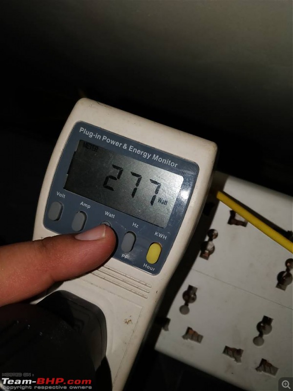

I have hooked up one of inverters after my home shift and connected to a plug meter to monitor power consumption. The inverter was disconnected for about 10 days and on hookup it was consuming 50-55W and drawing <0.5A.
The next day we had a one hour power cut and on power coming back, I checked and it was drawing 270+W at 1.35A.
My second inverter needs the molex pin connected back to the cable as shown in the last picture.
In my experience these plug-in meters aren't terribly accurate with inductive loads as with resistive loads. Use a clamp meter or an ammeter in series if possible.
