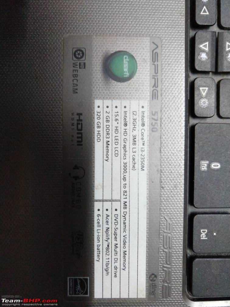

Dear All,
My dad is having an Acer Aspire 5750, few years old. He normally uses it with BSNL LAN connection at his home in Kerala. Now my parents are at my place in Chennai where I have ACT. When I tried to connect the laptop with Wi-Fi it says Limited Access and not able to browse internet. I have attached a couple of snapshot of the system details so that experts out there can troubleshoot. Is it something to do with the Wi-Fi router settings?
Before querying here I checked the Acer forums and found few responses as well but it's not working in my case.
Please advise.
Thanks in advance.

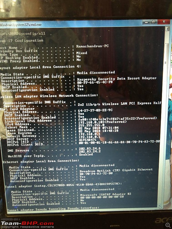

Hi, thanks for persisting with me. I am not familiar with PC troubleshooting, but as per your instructions got the below information. Please check and advise.
The Laptop Thread: Configs, deals & questions-1525227042805.jpg

Re: The Laptop Thread: Configs, deals & questions
Could you show us an output of the same command when connected to ethernet cable?
Hi, sorry for the late reply. I have attached below screenshots with internet through LAN cable.
You get a 169 ip for wireless adapter. Is it currently disabled? If so try connecting to wireless and see if you get a different ip address.
Disconnect eth cable and try ipconfig /release then ipconfig /renew. This should request a new lease from the router.
You could also try assigning a static ip to the wireless card. type ncpa.cpl to bring up network adapter settings then right click on wi-Fi adapter -> properties ->double click Internet protocol version 4 - > select use the following ip address and fill in the following
IP add - 192.168.0.10
subnetmask - 255.255.255.0
default gateway - 192.168.0.1
while connected to wifi could you also provide output for ping yahoo.com and ping 4.2.2.2
navin_bhp is offline
Both, wireless and LAN seem to have proper values.
Need one more test to be run :
1. Disconnect LAN cable
2. Connect via WiFi
3. Run following commands:
ping 192.168.0.1
ping 216.58.220.14
ping google.com
nslookup google.com
And give us screenshots of output

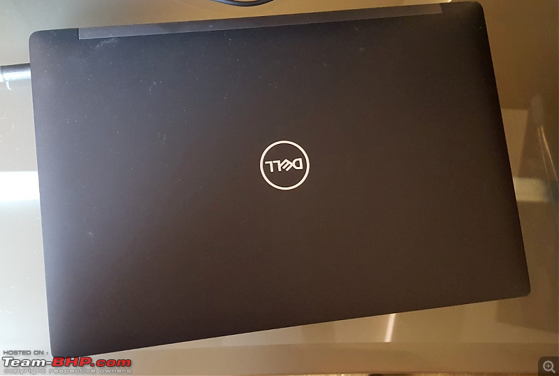

Based on the advice on this thread (thanks for that!), I got a new Latitude 7490 with an 8th-gen Intel, 16 GB RAM, 500 gig SSD etc. It's got double the power of my 5-year old E6430, but is half the weight, very slim (slimmer than my brother's Macbook) and is blazing fast . The docking port is also super small and doesn't take up desk space like my older one. Still learning Windows 10 though.
Question: I've been using Kaspersky on my Windows 7. Is it still the best? Or should I just use the preinstalled Windows Defender? What's the best anti-virus? Thank you in advance.
