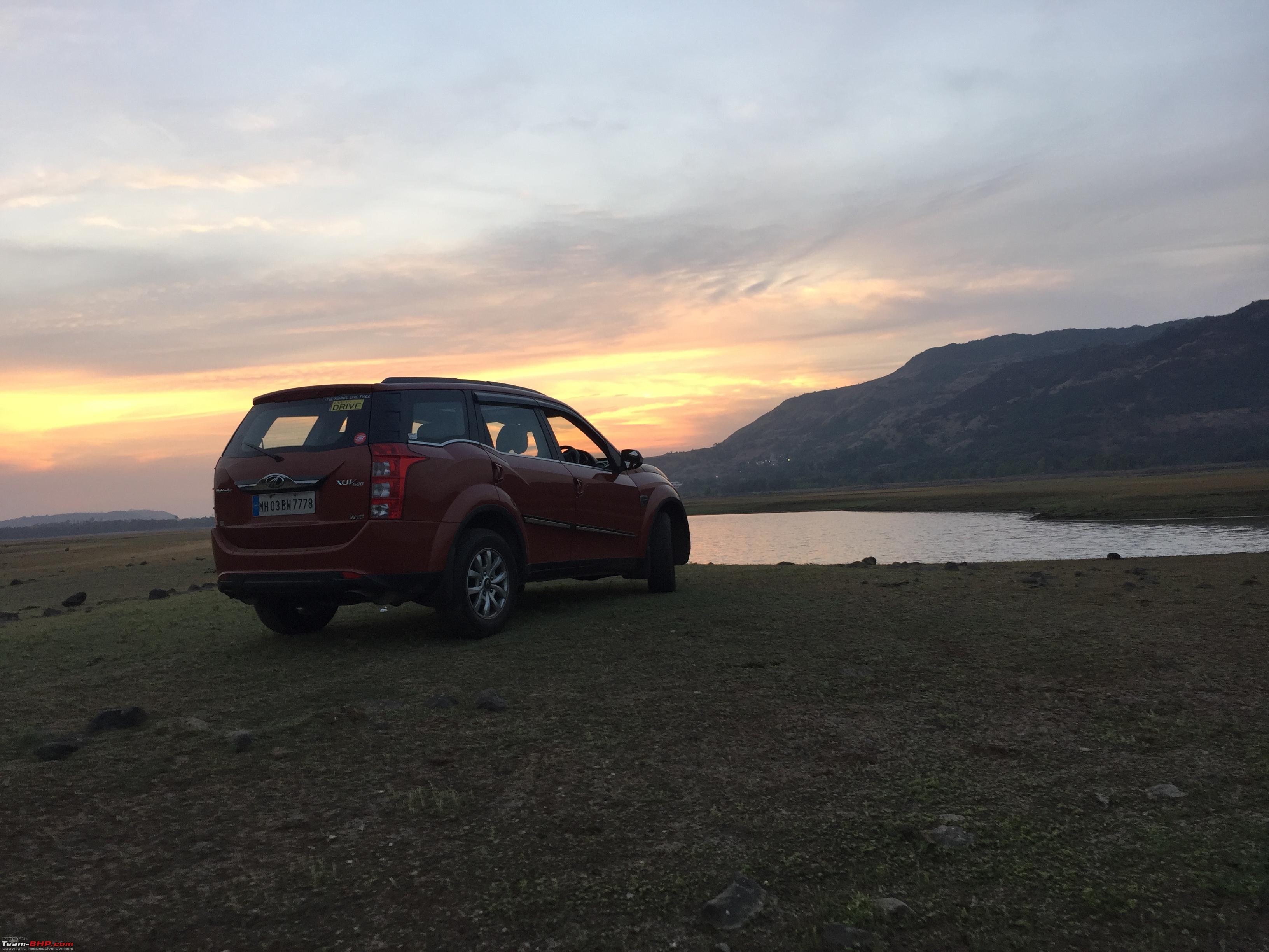

A sunday drive, A day well spent, Couple of pictures of the beast.
My Sunset Orange Mahindra XUV500 AWD W10. EDIT : 40000 km service update-img_8376.jpg
My Sunset Orange Mahindra XUV500 AWD W10. EDIT : 40000 km service update-img_8378.jpg
My Sunset Orange Mahindra XUV500 AWD W10. EDIT : 40000 km service update-img_8379.jpg
My Sunset Orange Mahindra XUV500 AWD W10. EDIT : 40000 km service update-img_8381.jpg
I would surely like to brag about certain road trips that i do, I hope Mahindra gets us the 3G and Wifi Connectivity enabled soon.
