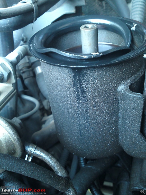

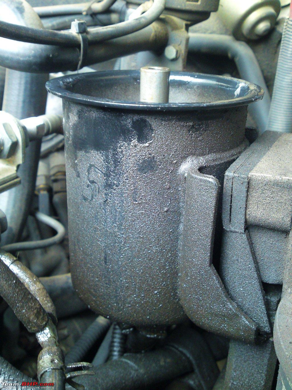

An old minor problem with the Sumo has been leaking of PS oil. The T.A.S.S used to check it during each service, but this time it had got a little too much, with a noticeable drop in PS oil levels.
So this time, decided to open it and have a look again before giving it for service.
Oil outside the PS oil tank :
Truckin'.. A journey of 7 years, 5 months & 78300 km with the Sumo Victa GX Turbo-psoilleak1.jpg
Opened the cap of the oil tank, and this is what I see : a warped oil seal gasket. Note the cut in the gasket.
Truckin'.. A journey of 7 years, 5 months & 78300 km with the Sumo Victa GX Turbo-psoilleak1a.jpg
There were some rough edges at these points, which seemed to add to the leak. (Note the chipped areas)
Truckin'.. A journey of 7 years, 5 months & 78300 km with the Sumo Victa GX Turbo-psoilleak2.jpg
So used an old screw-driver to chip away at the rough spots. Care taken to not drop the debris into the oil. Once this was done, cleaned those areas to reduce the oil. Then a bit of Anabond 666 over these areas to smoothen the spots.
Have put the gasket back as it is (even though it is damaged). But atleast it is holding. Will pick up a new gasket next time I am near a T.A.S.S, to complete this issue.
