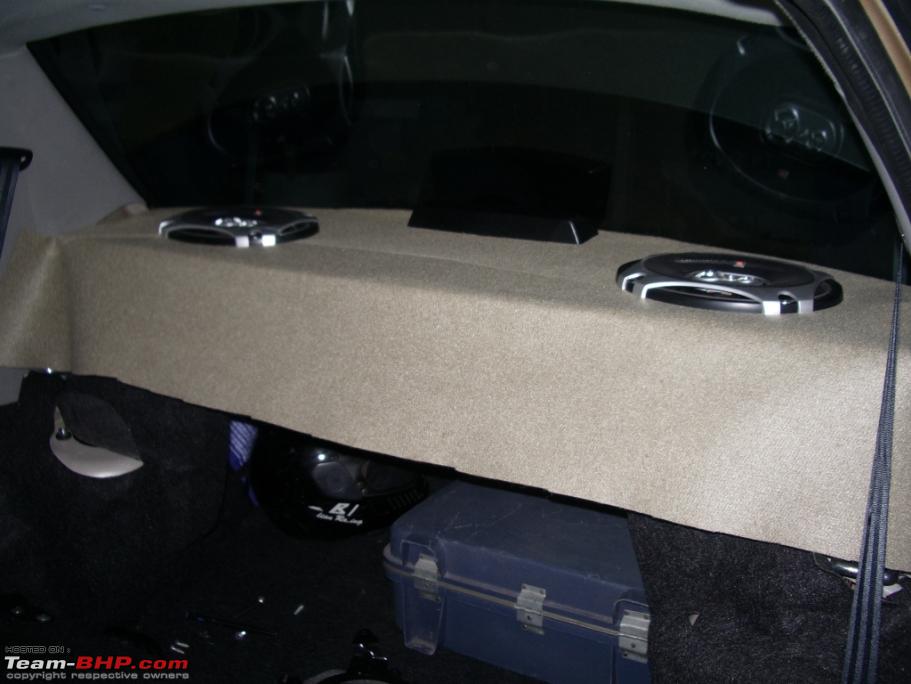

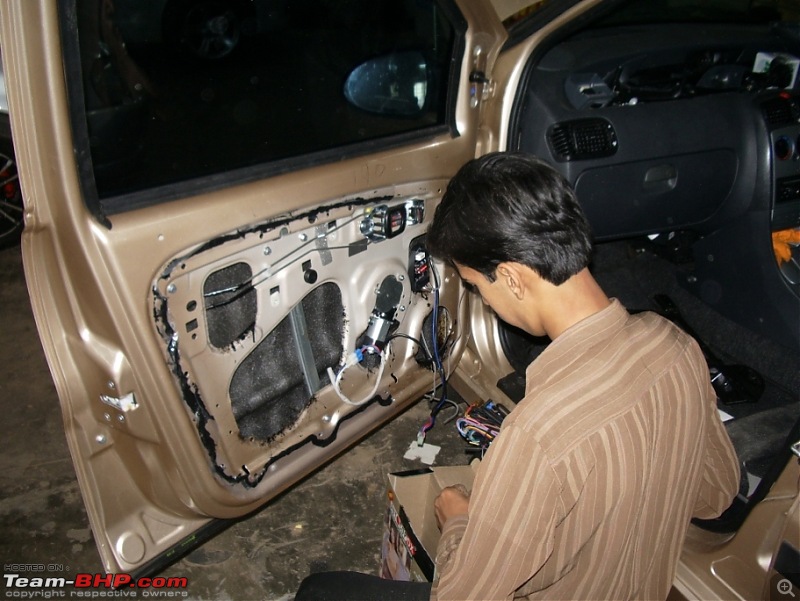

Njoy the ICE Install and AutoCop Central Locking install photos.
Done on 9-June-2008, Bangalore at Anwar/Thouqueer's Auto Fusion, Koramangla. Specs and cost in previous post.

why'd you settle for 5" comps. You could have gotten away with 6 inchers on spacer rings
Also , have you done something to the rear tray?

well I insisted to keep it stock, probably why its stock ... whats the difference between the 5 and 6" comps?
the stock fiberglass rear tray is gone... plz wait for a more clearer pic - the one here is a wood plank custom made to fit the indigo/ca series. and the rear stop light is cut and made to fit here...
the stock one would have vibrated itself to death on the volumes i listen to !!!!

I was driving back with better half back to home from office yesterday, listening to a mild AR Rehman number, suddenly - a HUGE bang from the speakers, (rear). i pulled over, and pushed the codriver seat forward and saw the AMp light was off, there was a mild crackle in the speakers before that bang - I immediately took of the HU panel to make sure nothing works - and checked out the amp and all spekers for any burnt smell or something like that. nothing - so I left it there and decided to check it in day light.
Drove to Anwar's in morning and he still wasnt there - I explained the issue to one more installer - who did the work actually - and found the problem ASAP. If you look at the install pics a few posts earlier - you will notice the speaker output wire very close to the Seat frame... there was one fouling with one of the Steel seat frames while driving over bad roads. So it was effectively shorting out when ever it touched the frame.
I got the frame covered with plaster so that it doesnt foul any more - and took a real long TD till hosur and back - nearly 70Kms over VERY VERY bad roads and at high Volume and feel the problem is sorted out.
I was also assured the JBL does a Auto Trip every time it senses a short - there are 2 inbuilt fuses for the AMP and 1 more near the battery compartment. So he said there will be no damage to the amp unit.
