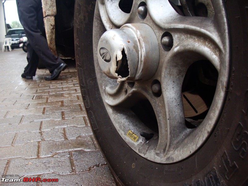

One small damage during the pan-India trip. Trying to park in a tight spot, the plastic ALH cover (the extended hub cap covering the front ALH) touched a high kerb and broke, fortunately without any apparent damage to the hub itself.
Hawk-On-Fours® (H-4®) with a tail - Scorpio mHawk 4WD EDIT: Sold!-hub1.jpg
This was at Manipal, and M&M dealer Karnataka Agencies at Udupi were kind enough to supply a new one for 287 INR, as well as fit it for free.
Hawk-On-Fours® (H-4®) with a tail - Scorpio mHawk 4WD EDIT: Sold!-hub2.jpg
