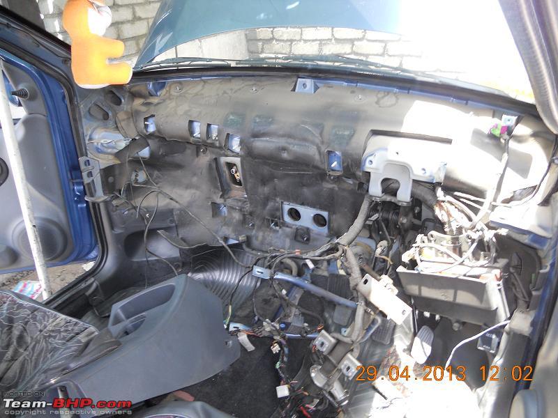

I did the servicing of my car's AC on 29th April, the first ever time & thought of sharing the whole experience with you. Though the AC was effective when driven with single occupant, it was not sufficient when car was fully loaded & rear passengers could rarely feel the flow. Moreover there was an upcoming trip to my native village where max temperatures were hovering in the range of 44 degree celcius. Hence I did not want to take any chances & got the AC system overhauled more from the preventive maintenance point of view. On last Monday took the car to the nearby AC repair shop, J D Enterprises (Jai Ganesh Vision, Akurdi) at 10am. The proprietor Donald (with whom I had fixed a prior appointment) promptly attended my car. He started the AC & checked the grill temperature just by feeling it. He said the grill temperature is good, but the flow is not sufficient. This being a Behr AC, the complete dashboard had to be removed to access the cooling (evaporator) coil. Vikas, the mechanic started opening the dashboard. The other mechanic Vijay had not reported on duty by that time (he turned up one hour late @ 11:30am). Just opening of dash took 2.5 hours & yes before opening, all the existing gas was released. The sequence of steps in AC servicing (with pictures) was as below:
Dashboard opened

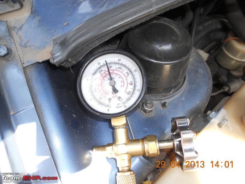

Car AC started & R134a Gas filled till sufficient coil temperature reached
The dashboard reassembly began At 3pm & was completed @ 5:30pm. Donald then brought a digital probe thermometer & put it on central coil to measure the temperature. Within 5 minutes it dropped down from 37 deg C to 1 deg C & then below freezing point. Ideally at 3-4 deg C the thermostat should have got activated & cut the off the compressor, but that did not happen. Donald then did some thermostat adjustment & it began working. Now the air flow had increased considerably. I then took a small test drive & observed than the steering wheel was offset from the centre position. Vikas then adjusted it to the correct position. I finally left that garage @ 5:30pm. I was charged Rs 2500. Normally they charge Rs 2800 for Behr AC & Rs 2500 for Subros. However since I was referred there by Venus Auto (my garage for regular servicing), I was given a discount of Rs 300.
In the last 5 days, I traveled 850 kms with 4 adults & loads of luggage in temperatures hovering around 44 deg C & (touchwood) the AC & the car behaved flawlessly (sunfilms did help a lot in keeping the cabin cool). For folks staying in Pimpri-Chinchwad area I would highly recommend this AC repair shop. Just for gas refilling/top-up he charges Rs 600 & top-up along with leakage testing (with Nitrogen & soap solution), he charges Rs 1200. He does the AC repairs right from Maruti to Mercedes cars.
