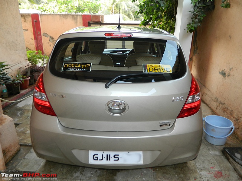

It was pleasantly surprising to see them work quite hard with keen interest (to address the steering rattle issue), they were willing to listen this time and trying to locate what the problem was. The APSM from A'bad was there too and he was supervising the work that day and he too had worked hard. The end result is that the steering rattle issue has gone( for now atleast)
Other work done too has been satisfactory, meeting or exceeding my expectations. They have certainly improved a lot, I hope they maintain this and improve further.
Hyundai i20 1.2 Asta - A rattled up year of ownership- UPDATE: rack replaced-svp1.jpg
Hyundai i20 1.2 Asta - A rattled up year of ownership- UPDATE: rack replaced-fv1.jpg

re: Hyundai i20 1.2 Asta - A rattled up year of ownership- UPDATE: rack replaced
Good to hear that the rattling is gone. And you have maintained your car really well.Does not look its 2.5 years old!! I always feel beige is a royal color for i20!
Keep updating this thread
sagarpadaki is online now   (1) Thanks
Old 7th May 2012, 08:03   #236
skanchan95's Avatar
Join Date: Jul 2010
Location: Mangalore KA-19
Posts: 1,332
Thanked: 6,539 Times
Regarding rattling issue, I need to wait & watch. As you know, the rattle seems to disappear for some time but has a notorious habit of returning after some time.
Thanks mate, I will . You too update on how things are after replacement of steering related parts in your i20.
skanchan95 is offline
Originally Posted by CARDEEP View Post
Hi @skanchan95, it is nice to see that Hyundai attended your car & the steering & other rattle worked on for Rs.NIL (I understand that you paid for car service).
Yes, they did, but all this was after a court order to get the issues in the car rectified ASAP to our satisfaction. For now, the issue seems to have been solved, but need to see how the latest "fix" holds up. The whole issue is now being monitored by the court and our lawyer will report back to the court if the issue crops up again within the next 2-3 months.
This was the fourth steering rack( and third steering column) that was installed in the car.
1- Original Steering rack
2. Rack Replaced in April 2010
3. Rack replaced in July 2010
4. Rack replaced in April 2012
While all this is being done as the car is under warranty,God knows what will happen when the third year warranty(extended) expires in September 2012. If the issue crops up after that, why should I pay for something that is essentially a shameful fault on Hyundai's part( design defect that causes the steering rattle issue to recur)?
While the APSM was decent enough to say that they will support me till the issue gets solved, I am still not convinced about their support after warranty expires. Afterall, these were the same guys who claimed that I was "hearing" things .
