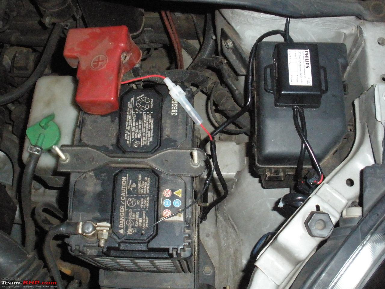

The following pictures give a better idea.
No there is no relay. No cutting of wires required. If connecting to the parking switch, splicing may be required but I am not sure as I have not got the DRLs connected to the parking. They are always ON.
The fuse box (plastic tube) like thing that you see on the battery is a vibration sensor (included in the DRL package). Since the DRLs switch ON and OFF automatically, this is the device that helps in sensing whether the car is running or not. As soon as you start the car the DRLs switch ON and switch OFF 5 secs after the engine is shut OFF. When the engine is OFF just vibrate the fuse box thing with your hand, the DRLs switch ON and switch OFF after 5 secs.
Maybe I am totally wrong about the vibration thing, but this is what the installer said, and I experimented when the engine was OFF and the DRLs switched ON on vibrating the fuse box (tube) thing.
It is not due to the vibration. I have also installed the same in my car. It senses the change in voltage. In idle mode when the car is not start the voltage at the battery is close to 12.6-12.8 volts but as the car is started it is above 13.8 volts. It senses this and switches on the DRL.
It is some thing similar to this module...
Amazon.com: Axxess XSVI-6502 C.A.N. Data Turn On Interface: Car Electronics
It turns on the equipment when the engine starts
low_bass_makker is offline   (1) Thanks

Re: Philips India launches Daytime running lamps & an In-cabin Air purification syste
Hey, thanks for the info. What you say and point to certainly makes sense technically. Also, the DRL kit has an electronic starter.
But what amuses me is that, on shaking that tube thing the DRLs turn ON! What is that component? Is it a fuse? Does the same happen on your car?
If such a thing does not happen on your car, or any other car with this equipment, then I think there is something wrong with this stuff on my car.
Dolphin is offline
It does not work when I shake the starter. It must be loose wiring which could be the culprit in your car !!!
