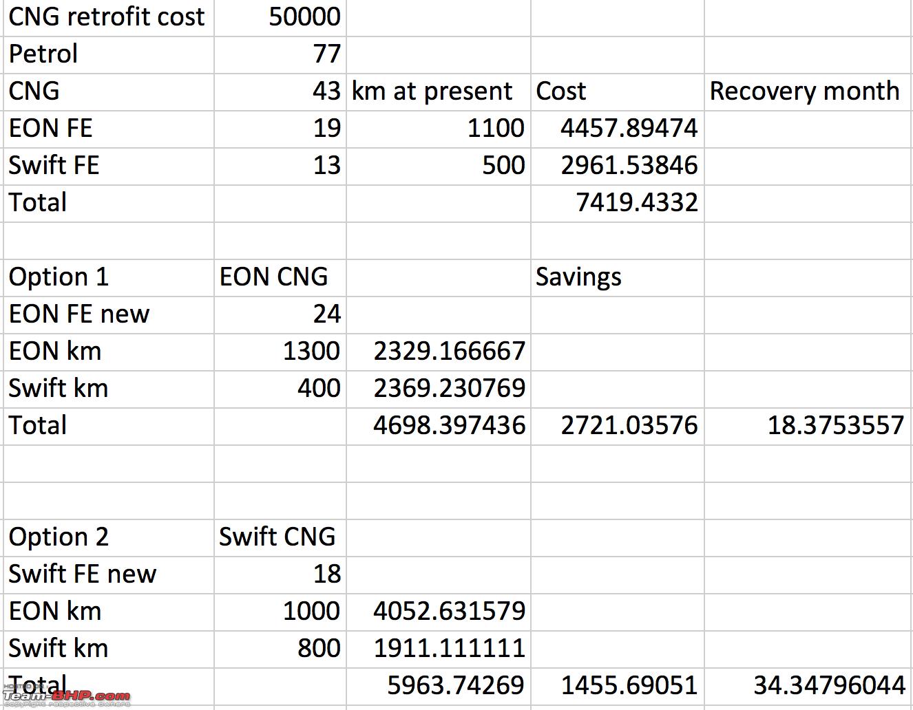

We are in a dilemma right now.
We have two cars in the house - Eon 800cc (7 month old) and Swift 1.2 (4 year old) - both of which are running on petrol.
The area where we live in has 3-4 CNG filling stations in 5 km radius and most petrol cars are already reaping benefits of CNG. Gas is available at Rs. 43/kg while petrol costs Rs. 77/litre.
Our Swift delivers 13 km/l overall FE while Eon gives 19 km/l overall FE. Both are driven with a light foot, majorly for city drives, on fairly open roads with less traffic. Our Eon does 1100 kms monthly and Swift does 500 kms monthly.
We have 3 options:
1. Fit CNG in Eon. Its running would go up to 1300 kms a month while Swift's running would come down to 400 kms a month.
2. Fit CNG in Swift. Its running would go up to 800 kms a month while Eon's running comes down to 1000 kms a month.
3. Do not fit CNG at all as it will cost us around Rs. 50k in either of the cars, thus outweighing any advantages for first few years.
A major problem with option 1 is that Eon is already underpowered with AC, and CNG will further kill whatever performance it offers. But financially, fitting CNG in Eon seems better as it is used for more kms every month. On the other hand, Swift gives us very poor FE in summers and fitting CNG will take away the heart-ache we feel while filling Rs. 2700 worth of petrol to travel 400 odd kms. This leads us to use an inconvenient cab everytime we head out for city runs as cab travel often turns out to be cheaper!
Our local installer (though we won't get the kit from him) says Swift 1.2 is more successful on CNG than Eon as there would be no performance loss. He says Swift will give 18-20 kms and Eon will give 24-25 kms on a kg of CNG. How true or realistic is this? We were expecting 16-18 kms for Swift and 20-22 kms for Eon after CNG.
Please advice as to which option makes more sense in our case. If any more information is needed, I will provide. It would be great if someone could do a quick math to show if there will be any gains in the long run or not. Swift will be with us for the next 7 years (its running is expected to be around 1500 kms a month in the last 4 years) while Eon will go in the next 4-5 years.
Thank you.

Prepared a quick Excel sheet that I had made when I was in the same dilemma:
Option 1: EON CNG
Pros: Makes most sense as it has a recovery period of 18 months ~ 23,400 km later.
Cons: Prepare for a 20-30% drop in power. Not to mention the boot space going as well.
With a 4 more years of service you would save money on 30 months roughly.
Option 2: Swift CNG
Pro: 1.2L engine is easily converted to CNG and very less power loss.
Cons: Recovery time is 34 months ~ 27,200 km.
With 7 more years, and same km per month, you can save money on 50 months after recovering the cost of CNG.
Option 3: The same 50k invested would give you a yearly interest of Rs 5,000 minimum which is about 5% of your yearly fuel expense. Also consider added maintenance expense on account of CNG fitting.
In my case, I simply started using public transport and using the Abarth for the highways mostly and the Spark for local commutes. But do you realistically see keeping the Swift for a total of 11 years? I would advise you to maximise the usage of one car (which has CNG) and sell it off in the next 3-4 years. But frankly, doing less than 2k kms on a retrofitted CNG car is not worth it IMHO. You will never get a factory tuned spec. Aftermarket kits a good, but if you see your usage increasing on CNG, its best to get an Alto CNG (Eon replacement) or WagonR CNG (Swift replacement).

Thanks for the excel sheet blackwasp. This is exactly what I was looking for. Thanks a lot.
You are right. Honestly, going by the recovery period and savings (and lost opportunity cost of 50k investment), I don't think it makes much sense to go for CNG as our combined monthly running is around 1800 kms only.
What we'll try to do instead is increase the usage of Eon, clock some 50k kms on it and exchange it for some well-equipped car. It is already quite generous in terms of petrol FE at 18-20 kmpl. Messing with a good functioning car (be it Eon or Swift) is too high a risk considering the actual savings with CNG retrofit.
Haha, the Swift is a keeper. It has been cared for and pampered like a baby. We generally keep our primary cars (Eon is a beater) for 10 years and keep them in absolute top-notch condition. So, I don't see the Swift going anywhere till the next 6-7 years.
self_driven is offline   (1) Thanks
