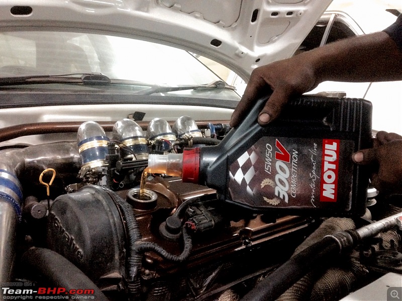

With no issues on the car, we had the fluids changed and replaced engine oil with Motul's 300v Competition line. Heat is our biggest enemy and without an oil cooler, we needed an engine oil thats proven to hold up against extremes. We had seen and head about a lot of the other brands failing on the track and it was a risk we just couldn't afford.
