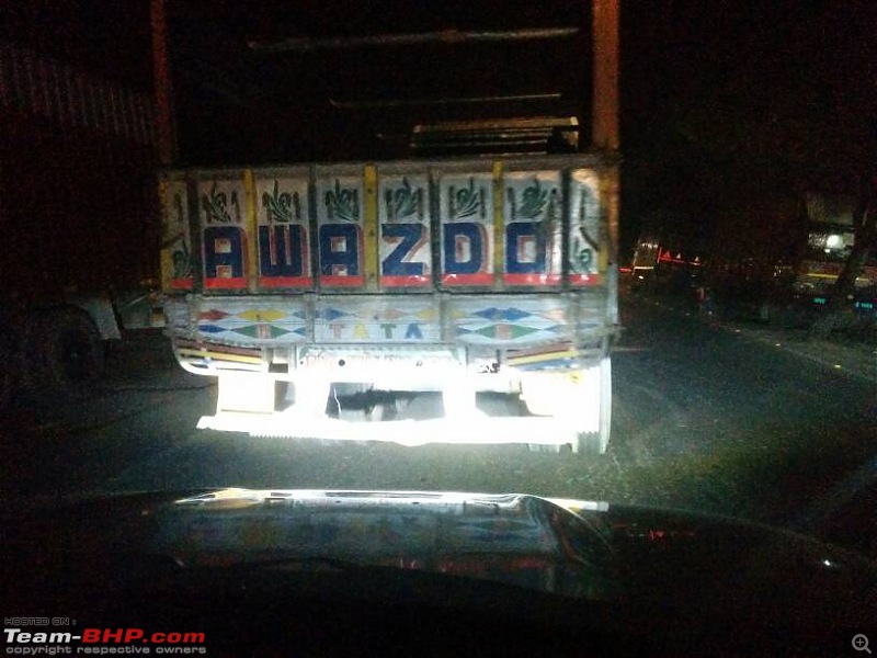

Finally fixed led bulb in right side assembly too by removing the bolts of coolant reservoir and making space to work.
I will say results are not excellent but satisfactory specially the spread and uniformity in the beam pattern. Attaching few pics.

Its really bright, the results will be much better on concrete roads rather than tarred ones.
A final shot below my house, the area was dark with less light.
Yet to test on highways with good speed, though in city the effect is not that great just satisfactory but I feel will work much better in dark and low lit areas.
