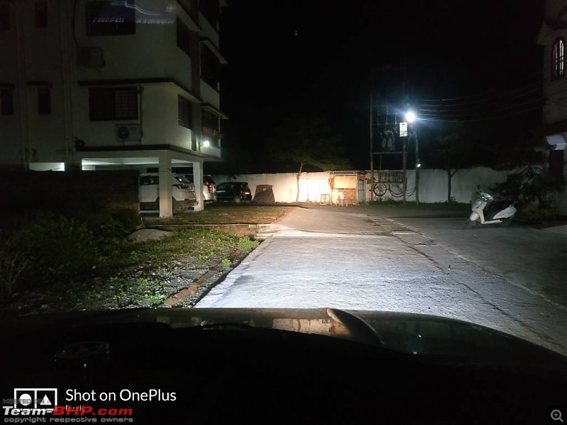

Hi everyone. Those who confused with the light temperature difference in fog light and low beam, i have just clicked few pictures to lessen the confusion.
With only fog light.
With fog light and low beam.
With fog light low beam and high beam.
To give you an idea, the front wall is approx. 20 metres.

Hi rahul. What we meant was for an onlooker from front, white fog and yellow low beam might look odd (just look wise). So if possible can you click a pic from front with low beams and fog on?
And thanks for these pics. They look fine as low beam is weak( xuv trademark &#128513 compared to those LED's.

Ya i will surely click from front and post it. It might look odd to onlookers but very comfortable from the drivers seat to drive at night specially in hills too and that's what matters more.

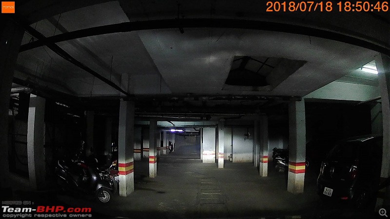

Re: Shadow problem is solved
Originally Posted by vinodv001 View Post
We have installed OSRAM Xenon H7 kit in the low beam and the shadow was prominent.
Yesterday the bulb was rotated 180 degrees and the issue is solved.
For enabling rotation, little bit grinding was done on the bulb opposite to the notch.
I was extremely frustrated with the headlights on my 4500 kms road trip (Bangalore - Varanasi - Lucknow - Bangalore) especially when it was raining. After coming back as the car was due for 2nd service, I took it to Shireesh Auto, Hosur Road and got Osram HID 4500K installed. There was a prominent vertical shadow but HIDs were way better than the stock lamps. Shireesh Motors' guy was not willing to rotate. I got the rotation done at my next door auto accessories shop. The shop is small but does a very careful job. After the rotation the HIDs work like magic. I also installed Philips Ultinon H7 for the high beam and H16s for the fog lamps. I end up driving in bad roads so better illumination is always useful.
1st picture is with low beams HID after the rotation. You can see no shadow.
2nd picture is with both low beam HID and high beam H7 LED
3rd Picture is both high and low beams with H16 fogs.
Pictures don't do justice to the actual illumination. For regular driving just the OSRAM 4500 K HIDs are good enough.
