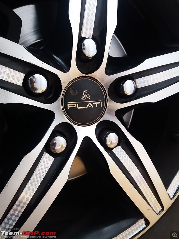

I found Scratch Out useful for removing rough marks on my alloy wheels castle nuts.
Before Scratch Out application:
After Scratch Out treatment:
mooza is offline   (1) Thanks
