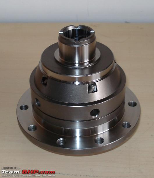

Finally after a long break my New Helical LSD has come in, this coupled with DMS should help me a lot to put down all the power i am craving for
Some Pics
Should get it installed soon.

Thats great newz!!!So when do you intend to begin the installation?? Or am i late in asking this question??

Thats thing looks lovely, man this is the most amazing build i have seen. How much have you runon these tyes, Any uneven wear?
