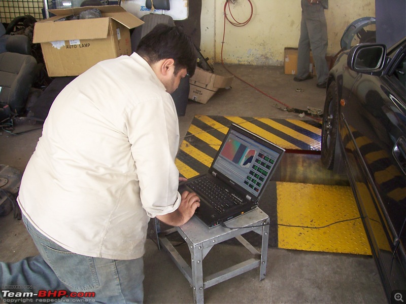

The beast:
The tooner:
Ground zero:
Hooking it down:
